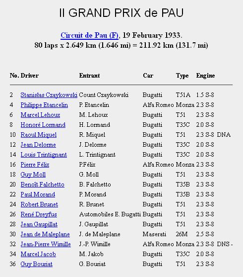

Michael Müller wrote:
Trintignant then raced #51128 at Pau on 19.2.1933
No.14 Trintignant with 35c 2.0 - this entry is wrong :?:

@ Uwe
Did you read this?
Quote:
There is some confusion regarding what types of Bugattis were present.
There are much more mistakes in that entry list, I will try to get that corrected.
