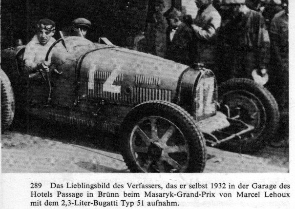

Photo was taken by Erwin Tragatsch in 1932 in the garage of Hotel Passage before the Start of the Masaryk Grand Prix

 Post subject: Re: Lehoux - T51 #51128 & #51144
PostPosted: Wed Apr 25, 2012 9:12 pm
The car in Tragatsch picture shows Lehoux with startingnumber 12 in the 1932 race. Therefore he must have owned or driven 3 different types 51. Tragatsch usually did not make many errors.
Why? I cannot follow you.
This was #51128.
The caption of this photo is correct of course, but also Tragatsch was not perfect. He was wrong very often, but his work is still the best we have covering the history of German Bugattis.
