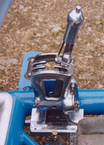

quite so.here are some of the gearbox and gearchange.
