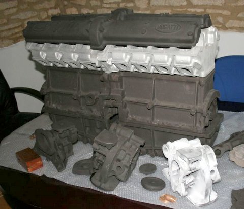

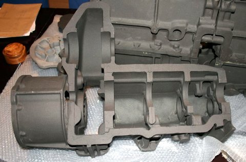

On the offchange that someone on this site is actually interested in a Bugatti Builder...here is progress on our new T251 engine/transmission assembly.It is 56 years since this type of engine was last made.Having the original factory patterns has been life changing for this project.Apart from the odd small piece,most patterns exist still.I had to make new "loose" pieces for the gearbox pattern.Using photos and small clues such as marks on the corebox showing where loose pieces have been lost.The small second half of the two piece gearbox case has yet to be sorted.I have all the coreboxes but not the outer pattern print.I am very glad that we have this round the right way ! If we had the outer pattern but not the coreboxes it would be impossible.The new outer pattern can be reconstructed from the coreboxes and also from photos.The mating face on the larger half gives us the necessary shape of the missing bit.

and some more.

And even more,The sump is another case where we had the coreboxes but not the outer print.A visit to the original car resulted in photos and drawings with measurements which enabled a new outer print to be made.The " water closets " on the end of the blocks were yet another case where the coreboxes were available but not the outer print.Surprisingly there were three separate cores for this small and relatively simple part.
