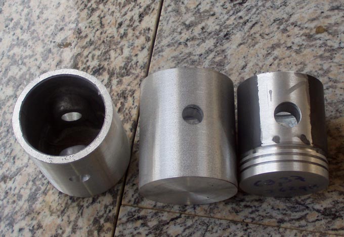

and if you can handle it . Piston blanks for 69 to 72 mm , specially made for Bugatti . You can machine any dimension you like . This blanks are cast in a preheated mold and 2 times heat treated . material
Mahle 124 , the best material for pistons today . Any questions ?

Are you suggesting that you machine your pistons on a conventional lathe?
 Post subject: Re: Read only , if you have a lathe -
PostPosted: Sun Jul 17, 2011 1:40 pm
yes , I use a conventional lahte .

Machined on a conventional lathe but not round?
PostPosted: Mon Jul 18, 2011 12:43 pm
yes !

It is perfectly possible to make oval shaped parts on a lathe. However, you will need to rebuild your lathe somewhat. Udo already showed the principle in another thread. Inevitable play can be accounted for by tensioning the cross support with a spring.
Dodgy lathes should be refurbished, or tossed. However, even on a dodgy lathe a good craftsman can make accurate parts. As long as you keep all play to one side of your measurements and fixed points. Besides that, no lathe is free of a certain degree of play or backlash. Even with anti-backlash nuts. CNC programs take backlash into account when calculating the neccesary movements.
For peace keeping: Play it nice!
