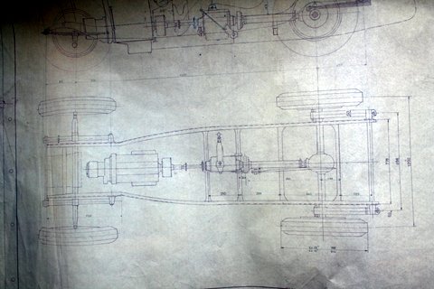

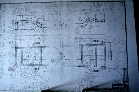

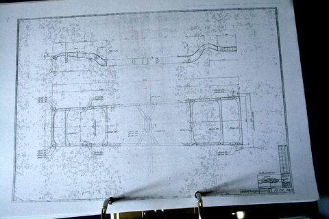

:lol: I really am fed up with lazy people who don't take the trouble to get their facts right about postwar Bugattis . I recently read a description of a T 73 c [ actually 002 ] where the author suggested that people could decide for themselves whether to call it a T 73 or a T73 c. How utterly stupid. Here for the edification of those who don't actually know the difference are the Bugatti chassis drawings of both models. Anyone unable to see the many differences is missing a few brain cells.The top drawing is of course the T 73 c . The bottom two drawings are the T 73 .

Uwe wrote:
Absolute rubbish of course. No T73A exists nor was one ever made. A T73A would be a T73A engined T 73. The T73A engine was made but never fitted.So no T73A was actually made.The car in the Schlumph museum is a T73 with a T252 engine.The drawing that I showed on my post was made for the modifications necessary to fit the T252 engine into that one single car.Incidentally , 70mm x 70mm , as shown on your specification chart for the bore and stroke of the T73/73c, would give 1077cc. Somewhat odd for a racing car designed for the 1.5 litre formula...and wrong of course.
