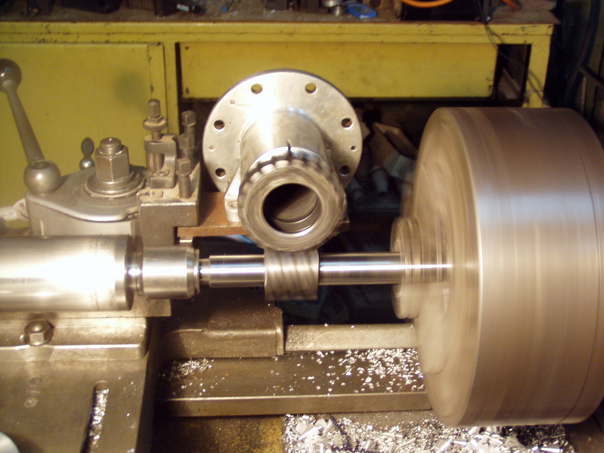

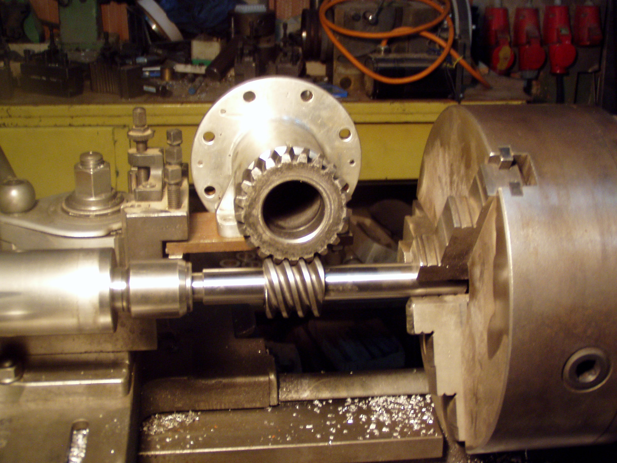

If the axle move back and forward , new bearings and shims . Your box has axial roller bearings ? If you like to investigate a new steering box , I have original and new ones .
"play between the teeth of the wheel and worm". Easy , you take the pins out , and move the front part up . Tight the nuts and drill new holes for the pins . That the way Bugatti did it .
 Post subject: Re: PUR SANG Quality?
PostPosted: Wed Feb 03, 2016 12:43 pm
The best way to get the perfect steering box . Diamond dust with oil . Common practise for high precision gears . But car people , especially Bugatti " experts " still do not know about it .

no, it's not the axle of the worm that moves back and forward, it is the space between the teeth (i think).
Fantastic!!!! newer thought of that. respect, you know what you are talking about!
i thought of eccentric bearings, but couldn't imagine how to measure it and fabricate and who will do it and so on.....
BUT...i am not sure if it works on my one because i am afraid the teeth could touch the ground without solving the problem of slackness. than it seems it's time for the vice and the grinder...
as i wrote, there is only one position where the wheels are turning - one teeth further or back and the steering is blocking!
yesterday i assembled the f...ing (sorry) steering and spend a lot of time to find out how to make the stuff with the locking wire. seems that i have to do it again and test your advice, hoping the alloy part will not look like emmentaler after i am ready..
apropos pins, PS put one pin in the housing without drilling holes on the other side so they had to break the end of the too long pin off - unbelievable.
great pictures, thanks - lot of work to make it perfect!
by the way - how much would be one of your steering boxes? you have the arms also? the "original" have lot of deep scratches and holes in the ball!???? (epileptical use of a grinder?)

With engineers blue you can make a very good steering box . But time consuming .
