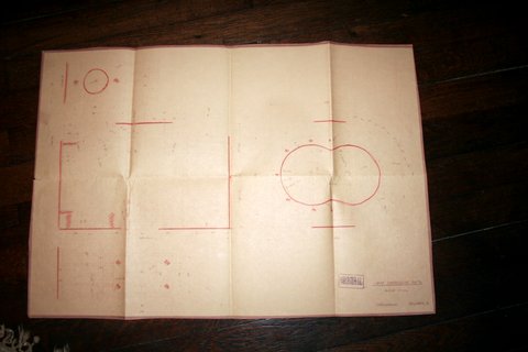

Not bad given the nature of the circuit.Here are some photos of a very unusual Bugatti drawing which I have explained elsewhere on the site.
