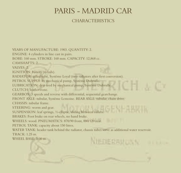

Hallo Udo, sind diese Angaben von Hucke/Kruta soweit korrekt?

Da sind auch einige Fehler . Wo holen die Leute nur immer dieße Info her ?

It is nice to indicate that there are errors, but which ones? Waht are the correct specifications, so that errors in future can be avoided!

I believe nobody really cares about it . For example , who cares if in the book the Type 5 has a fuel pump , but in real there is no fuel pump at all .
