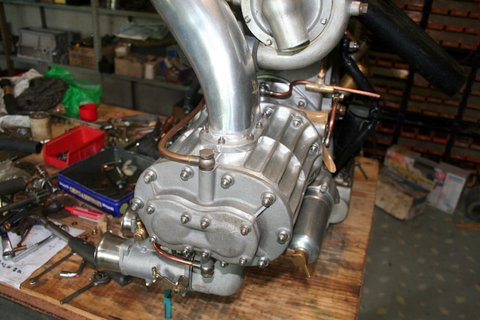

I agree with you Greg,sadly no one apart from me is interested in the postwar Bugatti's otherwise we could have fun chatting about the T73C,here is my engine just about ready for bench testing [ after only 27 years]

The observant will have noticed that Bugatti provided an automatic oil feed to the front [and rear ] blower bearings.The oil system is quite special,the pressure relief valve has two valves in it.This of course cannot possibly work as the weakest will always open first and the stronger will never open.But they are not both pressure relief.The weaker valve is a non return valve to keep oil up in the head and all the oil pipes.This caused much head scratching until it was fully understood.Most cars have the second valve removed.[probably because people could not work out what it was supposed to do.] Leaving it out seems to do no harm.

I personally do not believe that the non return system can work as it is arranged.There are two feeds to the supercharger gears on top of the "supercharger bellhousing".These are on the same banjo bolt as the camshaft feed pipes [ two at front and two at rear ] there is nothing to stop oil from the camshaft pipes bleeding down onto the blower gears when the engine is stopped.If the blower gears got their oil from the main engine feed then it might all work as designed.Of course there is no guarantee that the pipes fitted to the four complete cars are as Bugatti wanted them to be....These cars were supplied as "kits" for owners to assemble for themselves.........
