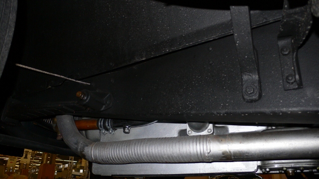

do you have a foto from a normal 57 sump ?
 Post subject: Re: 57s engine
PostPosted: Sat Jun 23, 2012 10:24 pm
I can take one by tomorrow when I lie down under our car.
Basically it's rectangular as long as the engine with short cooling fins and it has a capacity of 15 liters of oil.
The 57s had dry sump if I'm well informed.

Here they are...

I can't really see any big difference .The 57s sumpf is supposed to be less high compared to the normal one . How much , maybe only some centimeters ?
If it is a 57s sump , how can the engine number look ? 5 or 3 numbers ?
