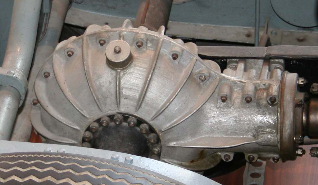

how can it be , totally different type of fixing to the axel trumpet ?
 Post subject: Re: T57 differential

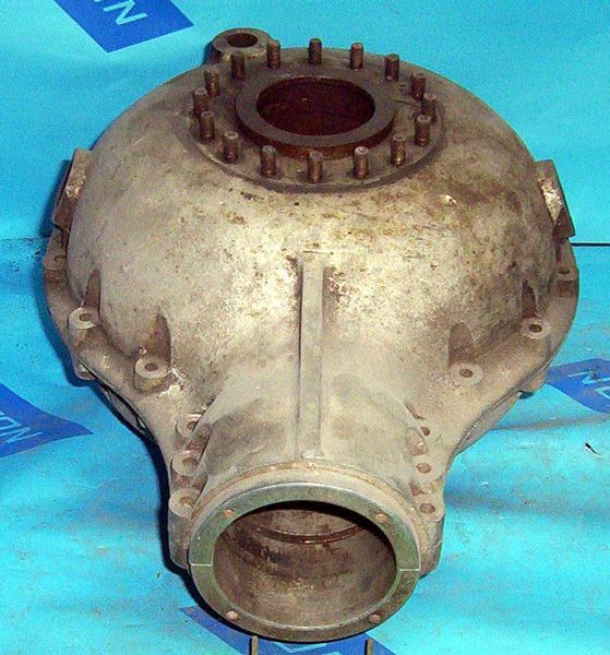

PostPosted: Mon Jun 18, 2012 11:25 am
Hi Udo, that is a late centre casing with the ribs, Trumpets to this will not fit the older style diff or vice versa, the late T57 and Brescia are two types that have less interchangability attched is a photo of an early T57 casing i beleve its essentaly the the same as all other 4 bolt touring cases.
Yours i beleve also has 9mm bolts?

It looks to me like a T35 casing . Is it maybe the same ?

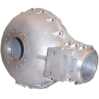

PostPosted: Mon Jun 18, 2012 2:07 pm
Yep almost the same as a 35 but Torque arm flange is different this is a replica part but it shows a 4 bolt flange. It is upside down so to speek, when alterd to fit a GP it was common practive to remove bottom right corner making a 3 bolt ala GP?
does that make sence?
