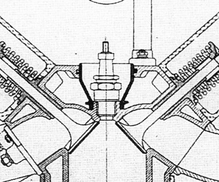

after welding ( not gas welding ) inside the cup , you can take it off easy .
I have owned four T57 cylinder blocks, every one of which had damaged cylinderheads where people had tried to remove the plug cups.A repair cup loosely fitted inside the original with a modern Locktite is the safest way to sort out this problem.
I do support Lazarus here. The Udo method has a guaranteed 50% failure rate. Never ever try to pull the old cup out but machine it out. There is a very useful T57 workshop manual available form the BOC that describes three different methods for repairing these leaks. Although this manual has been written a long time ago it still contains a lot of good general information about the T57 engine.
Do follow the suggestion of Lazarus if you have only one minor leak and you are reluctant to disassemble of the engine.
Hi,
I don't see a reason to disassemble the engine for the moment as it just runs perfectly, the compression is excellent and even on all cylinders, no suspicious noise, the oil was clean at the oil change without any chips in the filter and the engine was supposed to be rebuilt a while ago before we acquired the car, whatever rebuilding means to some people.
I guess that I will turn new cups if there are no insert cups existing on the market and follow your advice.
Would you suggest machining the lower bottom of these cups with an M18 spark plug threat allowing them to be screwed into the plug hole or would you fit them with a separate plug fitting?

the Udo method is not from Udo . It is from Erik Koux . I look if I still have a example and show you a foto .
I read in Bugantics that a guy used stainless egg cups, which had a near-perfect fit.

 Post subject: Re: T57 Technical information
PostPosted: Sat Apr 28, 2012 12:04 am
if it helps
