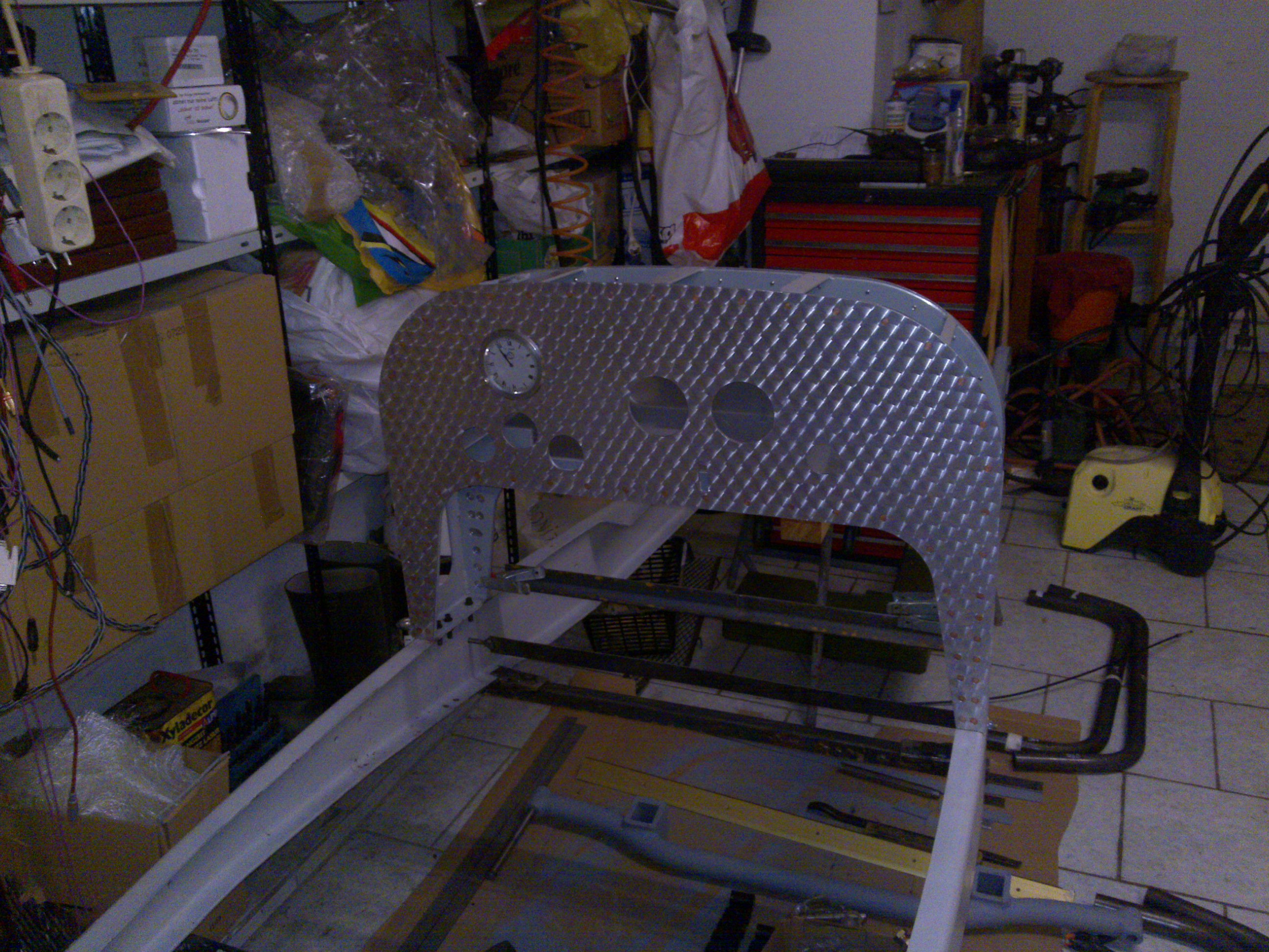

Selfmade Dashboard on selfmade frame - Status 27.2.2012

Hallo Aviatiker,
could you tell me please, what kind of metal sheet did you use? Is there anybody who has got an expirience in this subject? Of course I'm thinking about the forged chaisses.
Best regards
Marek

Chassis: Steel ST360 4mm thick
Dashboard: Aluminium 4mm thick, the underconstruktion also Steel ST360 4mm thick.
Pictures under www.orc-austria.at "Projekte" - "T37"
Best wishes
Bernhard

Hi Bernard,Excellent work.A couple of questions,You could so obviously make this dashboard exactly like Bugatti,you clearly have the skill so why change the method of making it? and secondly why is there a flat area on the top of the chassis on the left [ as there should be on the right for the steering box.] Are you planning links [left hand drive ] steering ?

The differents makes easyler the MG Midget 1500 ccm to build in!
We make a steelconstruction for the engine. This construction is a element from the dashboard!
The plate is on the left and right. It is formed on because we dispose the same basic steelelement (Lasercut steel 4mm) left and right side. Later we can cut it!
Bernhard
