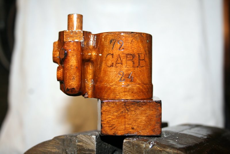

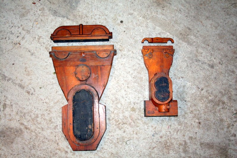

Here is the carburettor pattern and camdrive casing pattern for the T72.T68 camdrive at left.Compare the carburettor pattern with the carburettor in Japps photos.Surely this is not the same as the above photo? Is that not the T69?
