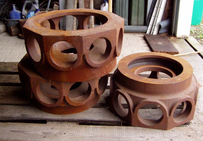

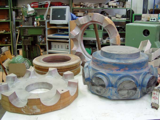

PostPosted: Sat Jan 01, 2011 8:06 pm
I use sand and lost wax steel castings all the time for engines . This are 3 engine crankcases 4140 , sand castings , heat treated to 120kg/mm². This engines have over 15 Liters .
