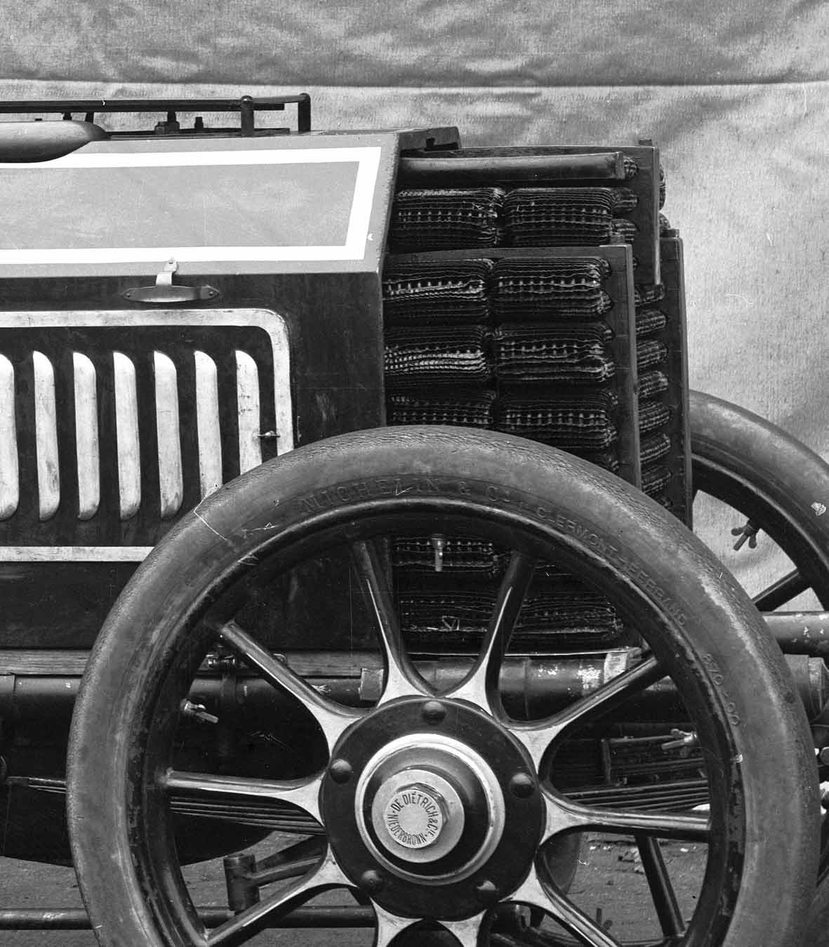

look at the fotos , original and the new one made in England .The original is a much bigger radiator and the design is differend . I have to make a new one .
I can test how many tubes are blocked .

The first Type 5 and Type 4 had only 1 radiator . But about overheating problems , the exaust manifold is inside the water jacket , both cars got 2 radiators .
PostPosted: Sun May 30, 2010 8:39 pm
Indeed I see a second one on the old photo above. And at standstill there is no fan to blow air through the radiator.
PostPosted: Mon May 31, 2010 1:23 am
A late Type 5 with 2 radiators
