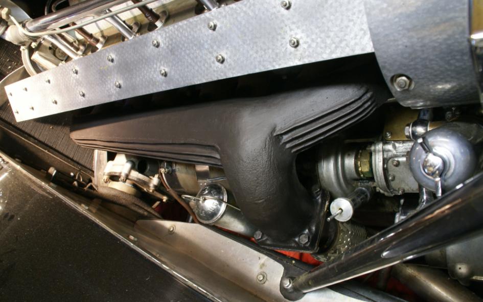

This morning I also made pictures of the exhaust side of my car, a type II engine. The type I engine was fixed solidly just as all previous Bugatti types- adding to the stiffness of the frame- but it also meant all vibrations were transmitted to the frame and hence to the inside of the car, although it still had a smooth ride in comparison to other cars. From February 1935 the factory decided to insulate the engine totally from the chassis by hanging it up in rubber blocks, which resulted in less engine vibrations in the car. The front engine bearers were provided with rubber mountings whilst the rear crankcase arms were deleted and a diaphragm was designed which bolted to the chassis and surrounded the flywheel housing (ref: Price type 57). This was called the type II engine.This however meant that also the exhaust manifold had to be redesigned, see this picture. By this one can immediately recognize the type I and type II engine.
However as the factory did not use chassis numbers but engine numbers (chassis numbers were only added at the last minute for registration purposes only) there is a wide range of chassis numbers where type I and type II were intermingled (such as 57297 engine 151 and 57298 engine 177 which both have a type I engine). But even engine numbers cannot make the distinction: engine 175 (57312, May 1935) and engine 203 (57290, February 1935) had both type II engines.
So for a while- including the building period of your car- these were intermixed.
