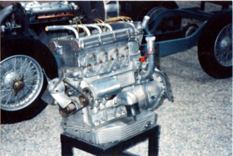

First photo Type 3, new head on new block camdrive at rear.Second photo Type 2, new head on T251 block with mods to produce a four cylinder.If any kind person lives near Mullhouse and could get some detailed photos of these different motors.This would really help me to sort out the patterns.Schlumpfs only got two of the 4 different types!

Here are two interesting moulds.On the left is the front corebox for the T251 cylinder head.Notice the central boss for the gear which drives the two camshafts.To make a T252 [mark 1] head you take all the T251 patterns except this one on the left and add the corebox on the right.This has the two bosses for the chain sprockets.The head on my car has 252 mot 1 cast on,although the second two is stamped as is the 1.It originally read [cast on] 251 MOT 5.Internal disagreements between Colombo and the "old Guard" led to a change of head to accomodate coilsprings instead of hairpins.The quality of the pattern equipement is self evident.

If I knew how to change the T251 to T252 I would ! But worry not the T251 has two T252 motors or the reverse if you prefer,The early T252 has half of a T251 motor.

Thank you I have these already but notice a couple of things in your revue,None of the T252 engines seem to have been supercharged.The T253 might have been but without the drawings it is impossible to say.The siamised inlet suggests blower.The T102 is definately nothing to do with T73.The T73 engine has four valves.The T73c uses the T73 motor.Small changes for the race car.
