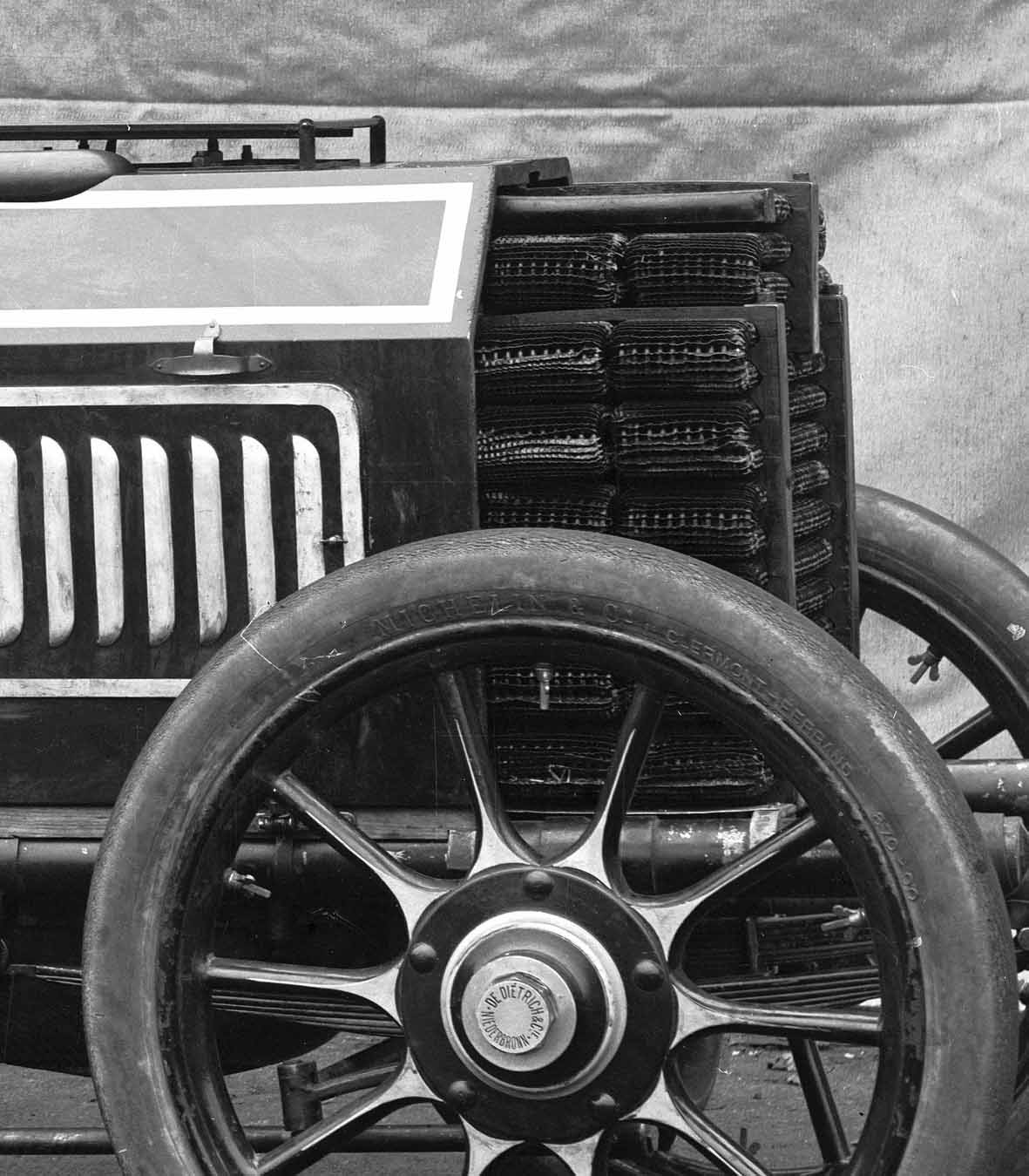

look at the fotos , original and the new one made in England .The original is a much bigger radiator and the design is differend . I have to make a new one .
I can test how many tubes are blocked .
PostPosted: Sun May 30, 2010 3:46 pm
In the radiator of a Ford Escort, there are narrow metal strips that are twisted like spirals, then inserted in the pipes, to increase efficiency. On top of that, I would increase the diameter. If the radiator is too efficient, there is always the possibility to plug one of the pipes, or even install a thermostat in a hidden place (oops, what did I say here!)
PostPosted: Sun May 30, 2010 4:03 pm
The first Type 5 and Type 4 had only 1 radiator . But about overheating problems , the exaust manifold is inside the water jacket , both cars got 2 radiators .
PostPosted: Sun May 30, 2010 8:39 pm
Indeed I see a second one on the old photo above. And at standstill there is no fan to blow air through the radiator.

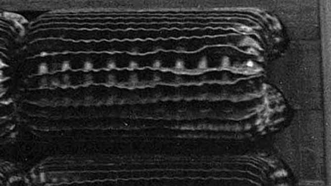

PostPosted: Mon May 31, 2010 1:23 am
A late Type 5 with 2 radiators

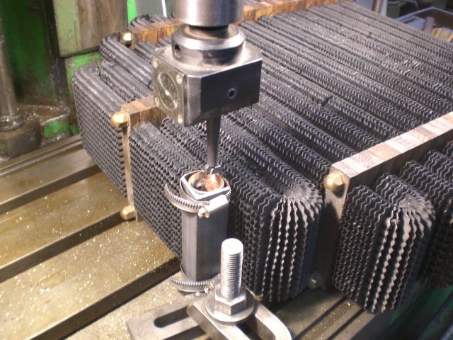

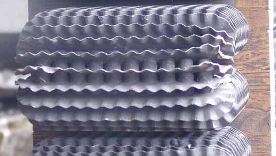

PostPosted: Sat Jul 17, 2010 11:43 am
The radiator had no openings It is brazed , and not soldered . To open it , I had to use the milling machine .
PostPosted: Sat Jul 17, 2010 12:39 pm
Do you mean they closed the ends of the pipes (one is visible) during manufacturing, and forgot to open them???
PostPosted: Sat Jul 17, 2010 6:14 pm
I do not anderstand it at all . Both sides are closed . For what reason ?There is no need for .
PostPosted: Sat Jul 17, 2010 8:05 pm
I mean the small internal pipes. They stick into the larger pipe which collects the water from the 8 small pipes. Were the small pipes closed? (the end of them)
PostPosted: Sat Jul 17, 2010 11:59 pm
the ends of the small pipes are open ( I hope so , maybe not all ) . Just one of the big pipes , the one collecting the 10 small ones are closed from both sides
PostPosted: Sun Jul 18, 2010 7:45 am
So the water is going nowhere?
