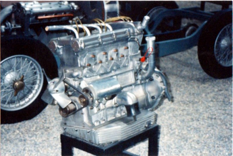

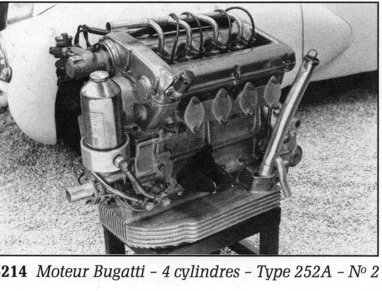

First photo Type 3, new head on new block camdrive at rear.Second photo Type 2, new head on T251 block with mods to produce a four cylinder.If any kind person lives near Mullhouse and could get some detailed photos of these different motors.This would really help me to sort out the patterns.Schlumpfs only got two of the 4 different types!

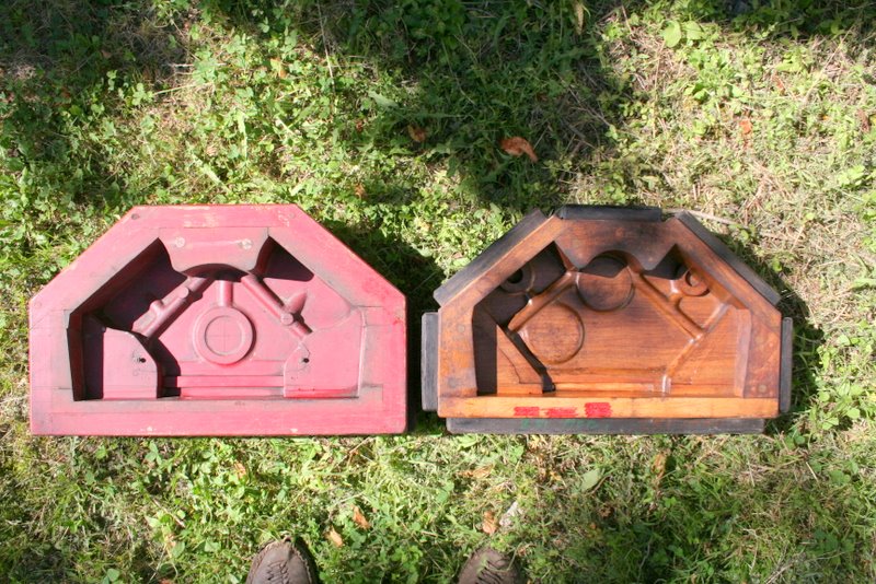

Here are two interesting moulds.On the left is the front corebox for the T251 cylinder head.Notice the central boss for the gear which drives the two camshafts.To make a T252 [mark 1] head you take all the T251 patterns except this one on the left and add the corebox on the right.This has the two bosses for the chain sprockets.The head on my car has 252 mot 1 cast on,although the second two is stamped as is the 1.It originally read [cast on] 251 MOT 5.Internal disagreements between Colombo and the "old Guard" led to a change of head to accomodate coilsprings instead of hairpins.The quality of the pattern equipement is self evident.

Photos were taken by myself, as far as I know these engines are not on show any longer at the Schlumpf museum.

Thank you I have these already but notice a couple of things in your revue,None of the T252 engines seem to have been supercharged.The T253 might have been but without the drawings it is impossible to say.The siamised inlet suggests blower.The T102 is definately nothing to do with T73.The T73 engine has four valves.The T73c uses the T73 motor.Small changes for the race car.

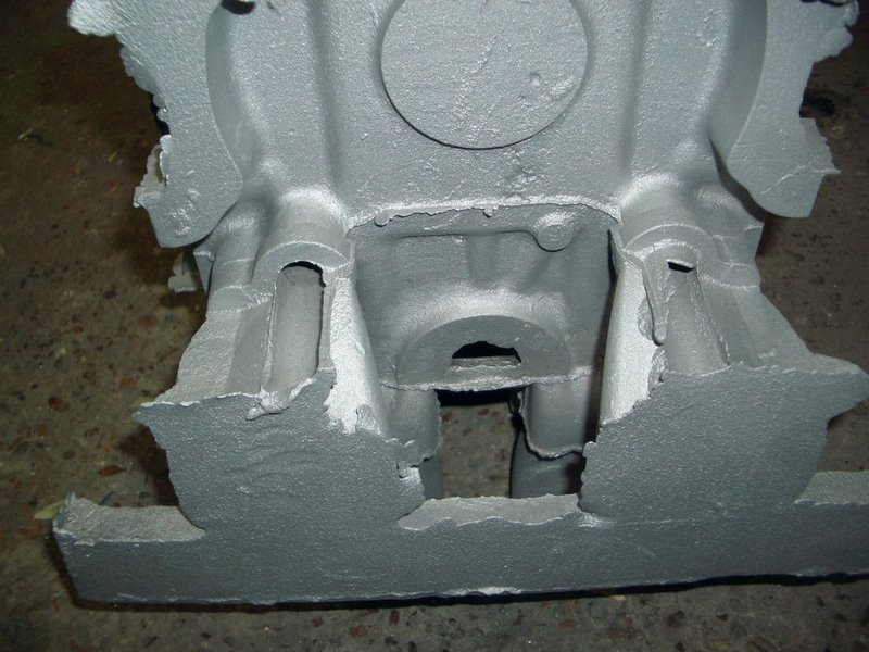

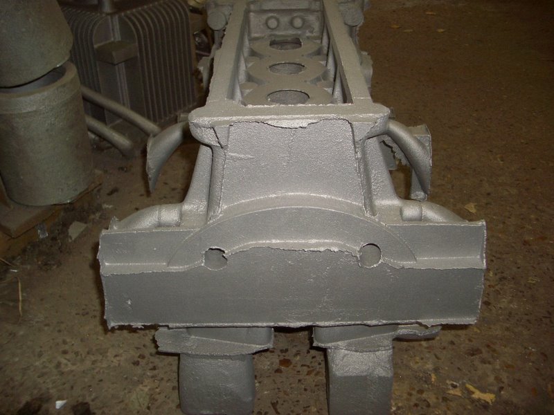

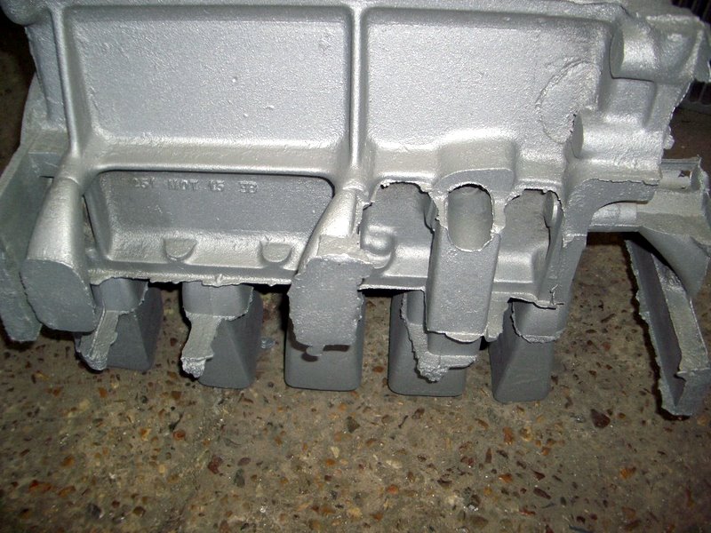

I think it is quite appropriate to show the first new Bugatti T251 block made in the original pattern equipment.This is the first time that a new T251 block has been cast since 1955.Over 50 years ago and in the 100 th aniversary year.Still a long way to go,but there is now a customer for a second new T251....This casting was done in LM4 to test the pattern equipment.The actual castings for the new engines will be as original in magnesium.

Does not look too bad, does it? Needs a lot of cleaning up and machining, but that is a different story.
What are your plans with this test casting?
