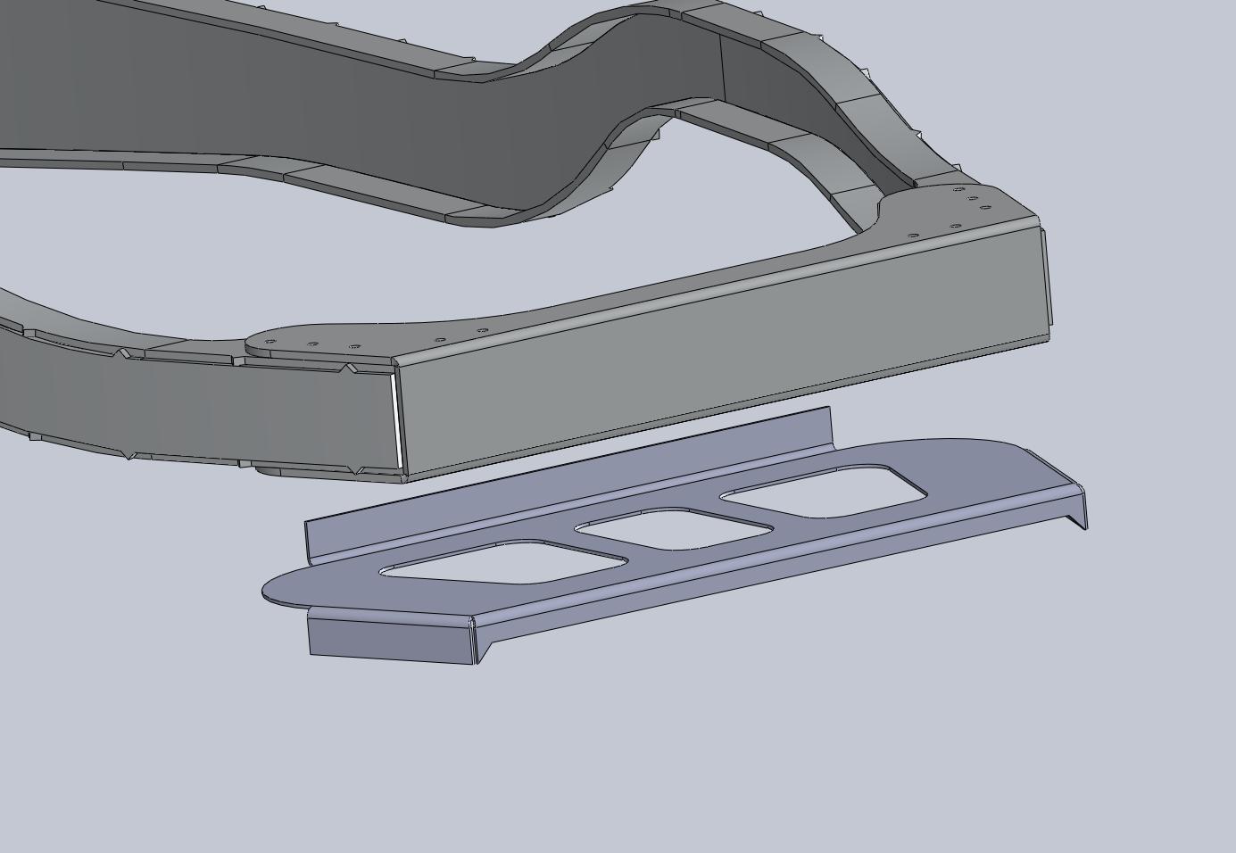

I did. there was 1 error....a radius if I remember correctly....but I don't remember which one.
Here is a partial view from one of my CAD drawings.

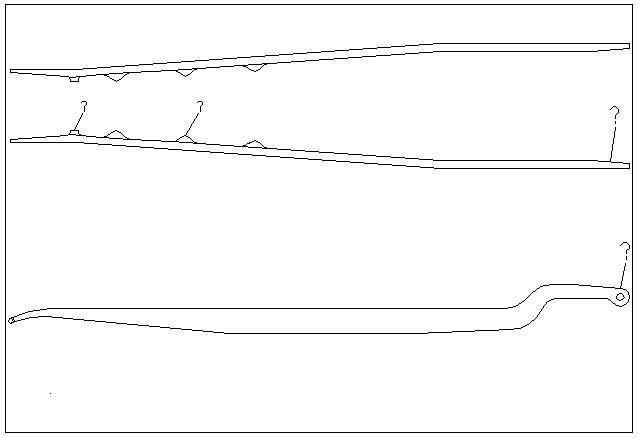

If you take the chassis drawing 41ch216 and look at original chassis fotos , suddenly there are some questions .
 Post subject: Re: Chassis drawings
PostPosted: Mon Jul 04, 2011 12:33 pm
Maybe you can make a scan of the drawing, as well as posting a photo of the actual chassis?
That way also those few of us who do not have access to 41CH216 can see what this is about?
PostPosted: Mon Jul 04, 2011 1:09 pm
I will look , if I can show a cad drawing , have to change the file to something .
PostPosted: Mon Jul 04, 2011 1:20 pm
you can send it to me, i will make it available (herman at bugattibuilder dot com)
PostPosted: Mon Jul 04, 2011 1:28 pm
dwg or dxf ?
PostPosted: Mon Jul 04, 2011 3:26 pm
voila
