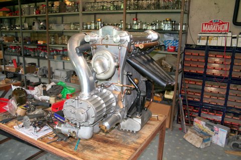

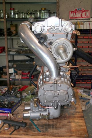

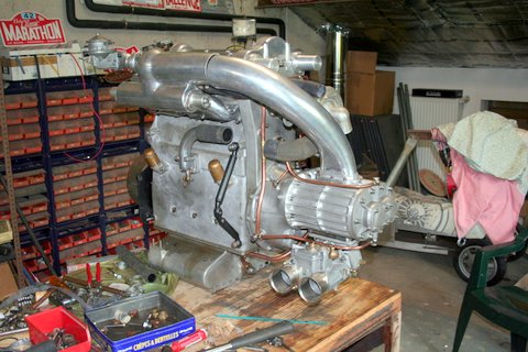

I agree with you Greg,sadly no one apart from me is interested in the postwar Bugatti's otherwise we could have fun chatting about the T73C,here is my engine just about ready for bench testing [ after only 27 years]

And another...

The observant will have noticed that Bugatti provided an automatic oil feed to the front [and rear ] blower bearings.The oil system is quite special,the pressure relief valve has two valves in it.This of course cannot possibly work as the weakest will always open first and the stronger will never open.But they are not both pressure relief.The weaker valve is a non return valve to keep oil up in the head and all the oil pipes.This caused much head scratching until it was fully understood.Most cars have the second valve removed.[probably because people could not work out what it was supposed to do.] Leaving it out seems to do no harm.

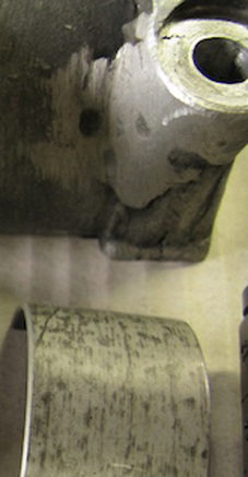

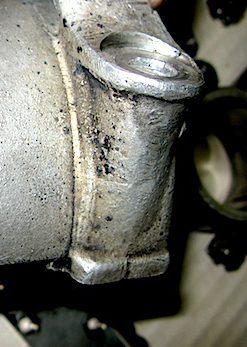

cracks in the main bearing caps . Is it a T57 engine problem ? This is the second t57 engine with cracks in nearly all main bearing caps .
