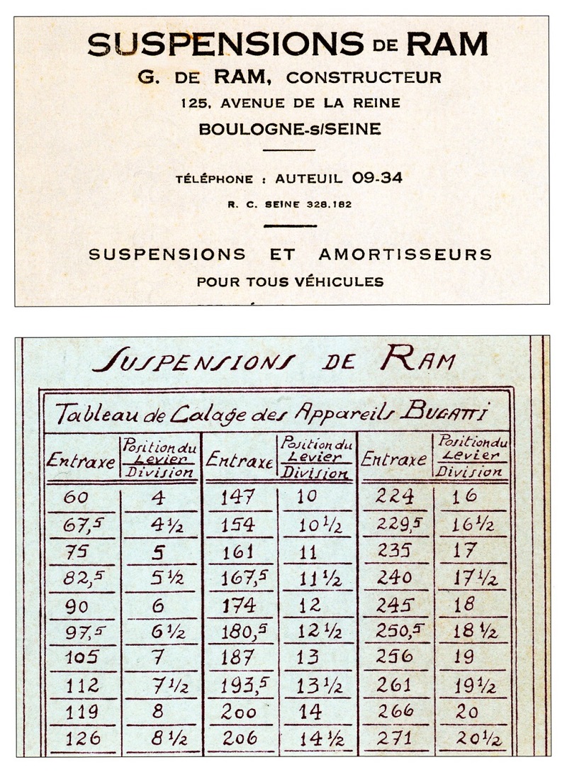

PostPosted: Tue Jun 17, 2014 5:37 pm

All the reading about de Ram does not really help . Best to take one apart and study the inside parts .
Uwe , do you anderstand the table you posted ?
