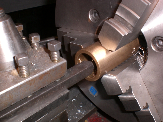

About the mechanism: does it move the whole tool holder, or does it turn the tool holder?
The gearbox at the back is 1:1 . It moves the tool only in the small slide .So if the
chuck turns 180 degrees , the tool moves from back to the front . Next 180 degrees the tool goes back . Operation speed is very slow , so not dangeres at all .
What is this machine doing ? Anybody knows ? Bugatti had a device like this .

the rears on top, both 1 to 1 are for the derection of the toolsupport if engaged. (While milling, the toolsupport goes to the left or to the right)
It is now not engaged, if it was engaged, the special mechanism could not work.
It looks like a divice to make closed oil or grease groves into a bushing. :roll:
After finishing the grove, you see an circular grove in the bushing. Grease can not escape while the grove is closed. An grove loke an 8 is also possible.

Jean , you got it ! I had to make this oil groves like an 8 in the bearings . For example , conrod Type 5 small end bronze bushings . I guess Greg can explain us , why all this bushings , made in England , do not have any oil groves ?

The solution of "pattes d'araignée" is no good, oil goes direct out of the bearing ! It's a long time that is know, and even interdicted by the international standards ISO...
