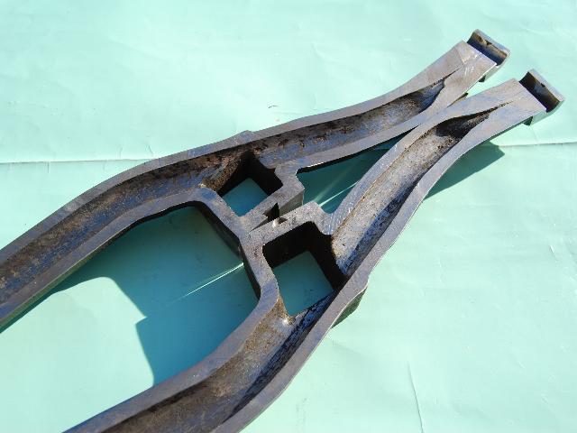

Hallo,
this picture showed the oryginal axel Bugatti T59. In T54 and T59 axel front was united with two symetric parts, but it wasn't weld for sure. In those days it was very popular that axel in GP cars (Sunbeam, Delage, Talbot) was consist with few parts, probobly the reason was to make easier the production technology. In oldest models of Bugatti this axel was made in one part. The photo below showed it the best. I think that hydraulic press is more usefull than welder. About the quality of steel, this problem was propoled in forum before, it was named as MH2, today it is 35HGS.
I mentioned those diameters of T43 and T46 because I see the relationships of proportions. I would like to know the exact diameters of axel front of T35 (technical drawings), perhaps somebody have got it and could throw it open. I think that it's not very difficult to reproduce this axel but it's nessesery to have the exact diameters and art spirit :D. I'm not involved to the project in Czech Republic but I'm interested in any projects of buildings Bugatti replicas. I know that it's work for years, for now I colect all information.
Look how easy is the axel of T73C.
Regards
Marek Jerzy

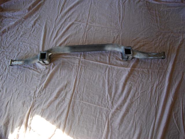

PostPosted: Thu Dec 30, 2010 9:43 pm
Is there somebody who has got any expiriences about building axel front for T35/T37?

 Post subject: Re: Replicas from the Czech Republik
PostPosted: Thu Dec 30, 2010 10:18 pm
I need drawings and dimensions those shields to T35/T37. Have you got any? Could you share?

PostPosted: Thu Dec 30, 2010 10:27 pm
Why not just contact the Bugatti Trust for the drawings?
Ivan Dutton ltd are making hollow forged gp front axles again now
PostPosted: Thu Dec 30, 2010 11:41 pm
How can you forge a hollow axel ?
PostPosted: Thu Dec 30, 2010 11:54 pm
Hallo Greg!
I know the address of Bugatti Trust. That what I'm asking it's just small detal which I lost. I thought that somebody can help me, I undersdend that just not you. Has Ivan Dutton Ltd got the monopol for the axel front? Are there people who build themselfs? It would be nice to know them. I think that exchange of expiriences would be interesting. It is olso part of Bugatti idea.
PostPosted: Fri Dec 31, 2010 9:49 am
There is a Bugatti patent describing the process. It is in many books. Basicly start with a hollow casting, then forge the ends shut.
