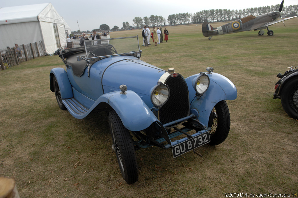

There was also this one wich was parked in the airfield space where they parked the WWII fighters
it is type 30 > http://www.bugattiregister.com/wiki/ind ... title=4315
