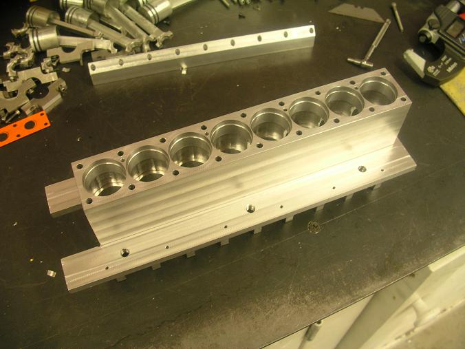

PostPosted: Thu Feb 04, 2010 2:19 am
Joined: Sun Feb 19, 2006 3:39 am
Location: Michigan
I never made contact so i measured and recreated the part from the scrap piece.
This is the new part with the water jackes and passages in it.
File comment: Picture of the new part
 Post subject: Re: 1/4 scale T50
PostPosted: Thu Feb 04, 2010 8:28 am
Well done!
You press in sleeves to form the cilinder walls?
