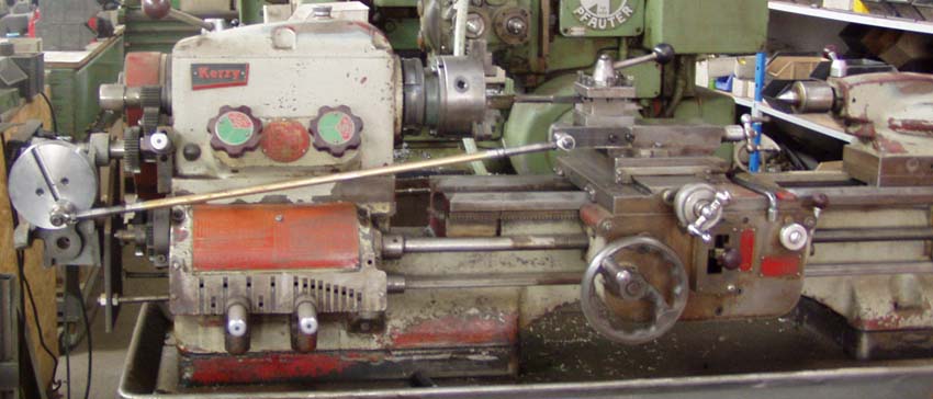

who knows this magic machine ?

It looks like a hand made tool to make splines into a milled part.
It's more a homebuild conversion to do the job

a dangerous tool made to be even more dangerous....
if any government safety inspector is looking you better hide thismachine cause he is coming to check your workshop very soon...

Greg , you will like this .
It is a Kerry lathe made in England . As a lathe not realy very magic , I think this is the reason the company is closed today . The conversion is made in Germany , but I did coppy a machine from a company in England . Somebody made the same conversion at South Cerney Engineering years ago . I think the company name today is Ashton Keynes .For the job the machine is doing , the machine is OK and easy to handle.
But it looks like nobody can see for what the machine is converted .

The age of machines does not tell anything about quality, or perhaps it does: The best chisels I have are really, really old, and actually are French (Peugeot)
About the mechanism: does it move the whole tool holder, or does it turn the tool holder?
Machining is all about tools, regular and special, to do a specific job. Most of the time it takes 2 hours to set up, to do a 2 minute machining job.
