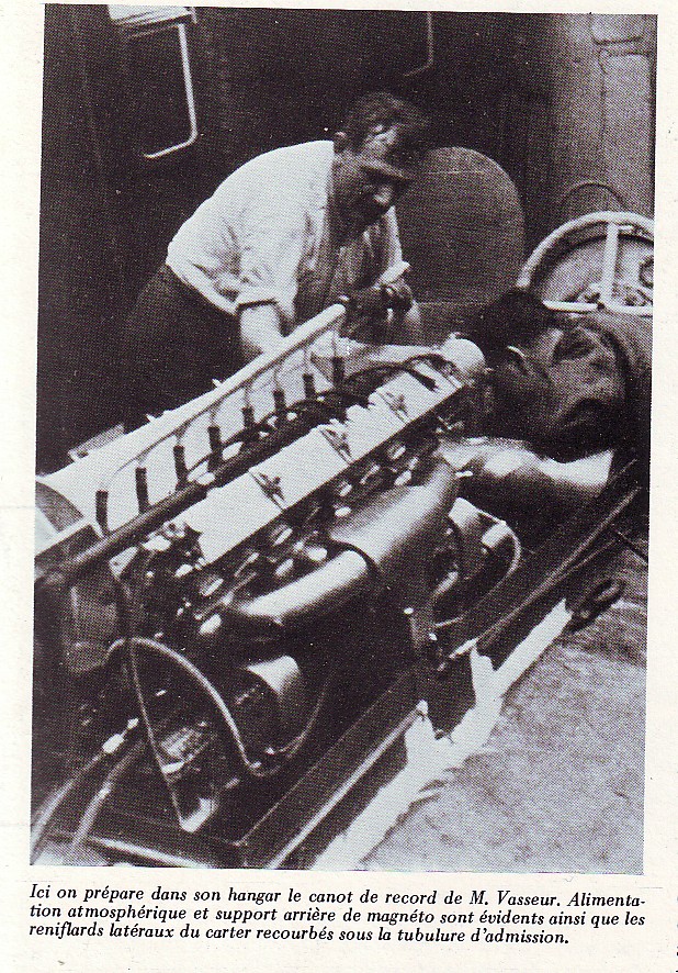

Are there any pictures of a Niniette, which show the engine (cover of engine removed)?

This is the best I can do for you. It shows the Bugatti engined boat of Vasseur but I don´t know if that is a Niniette. Better ask Martijn, he should know. Picture taken from Double Arbres by Jarraud.

Looking at the picture this is probably a boat with a Z-drive.
Martijn?
 Post subject: Re: Any info on the Niniette boats?
PostPosted: Fri Jul 03, 2009 1:03 pm
This is the Niniette 6, with hull and drive system by Bugatti.
The other Niniette's were made by Celli in Italy.
