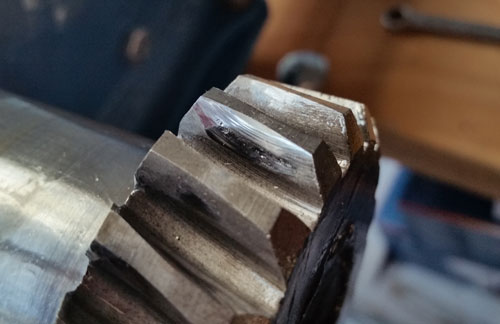

So the overlap of the gear teeth are sometimes only 1 mm .
you sure?
1 mm????
o.k. this steering is not the best, but 1 mm could not be true.
the teethes on my one are a little damaged because of different angles of the worm and the wheel, but seems to work - car is very, very old - about 7 years i think and worked for the former owners with this great piece of work ;-)
at the moment new bearings and grinding of the wheelaxle is made. let´s see if it´s getting better.
otherwise i have to buy a new one - and better not from Argentina ;-)
(but it seems there are 2 factories in argentina who are building 35B cars, and the other is much more better said the sales man :wink:.)
and then i will also replace the arms....the balls are looking a little terrible.
who makes better once (steering boxes)? and affordable (!!!) once???
until now the engine seems to run. but i don´t know what the former owner invested.
did about 800 Km last year.

Yea's - about 1 mm . But your gear looks completely different , is it hardened ? To find a company today , able to cut the right tooth is a problem . All use 20 degrees , because not many has the right tools .

I had it in my hands , 1mm , I could not believe what I did see .The big gear was not cut deep enough .
I know about gears , I have may own gear cutting machines including bevel gears . To cut gears is almost a science . And if you recalculate Bugatti gears , you always get a surprise .
This gears getting a overhauling, there is nothing to overhaul ? Do you know , how many degrees this Bugatti gears should have ?

no, no, no, not the gears - they are just like new ;-)
only some new slide bearings for the new grinded axle of the wheel to reduce the hugh (original) play of this part.
i have a video here that shows the problem that i hope to fix, but can't post it.
if i could make a new one (set of gears) i would do so.....but....i have only a vice and a angle grinder - what do you think....will it work ;-)
for the moment, i think, i have to live with that...LIVE i said. and: don't think about the quality during driving, hoping it will last some more years.

a vice and a angle grinder is a good start for a poor sang Bugatti . You can weld the damaged part , grind it , and scrape it with engineers blue . I know people they are able to do this by hand .

before you buy anything , show some pictures about the problem . Problem today , they all work with 20 degrees pressure angle because they do not have the right tools .

PA20 worm wheel/gear might work ok instead of PA14.5. More or less.
On the other hand additional 70-200 Eur isn't that much for the right tool.
