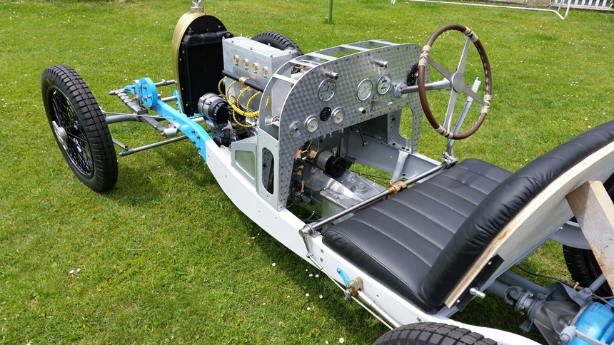

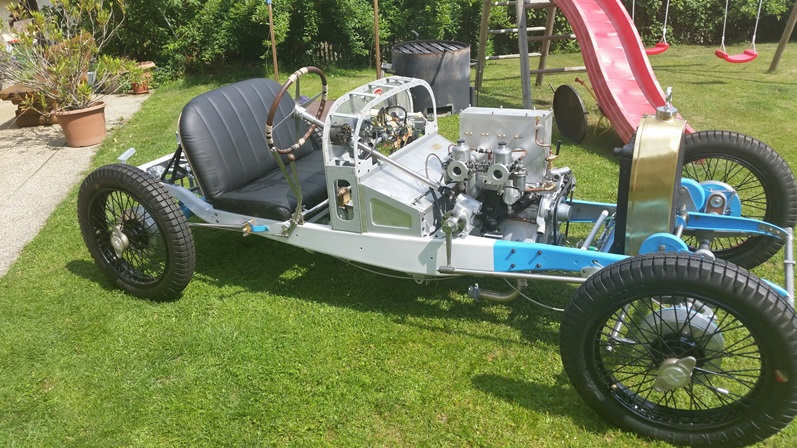

Hi Tom,
Best wishes for your Project!
I am also finishing a replica T37 Project!
Bernhard

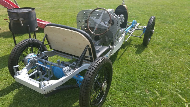

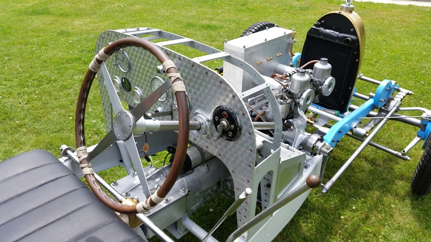

Hello quat-fro,
Yes all drive components are MG 1500 parts!
The top off the engine is a alu dummy near the original also the gear box upper part,
the gearshift is in full function from the outside!
Regards
Bernhard

That's a lot of effort!
The chassis appears very faithful to the originals, did you make it?

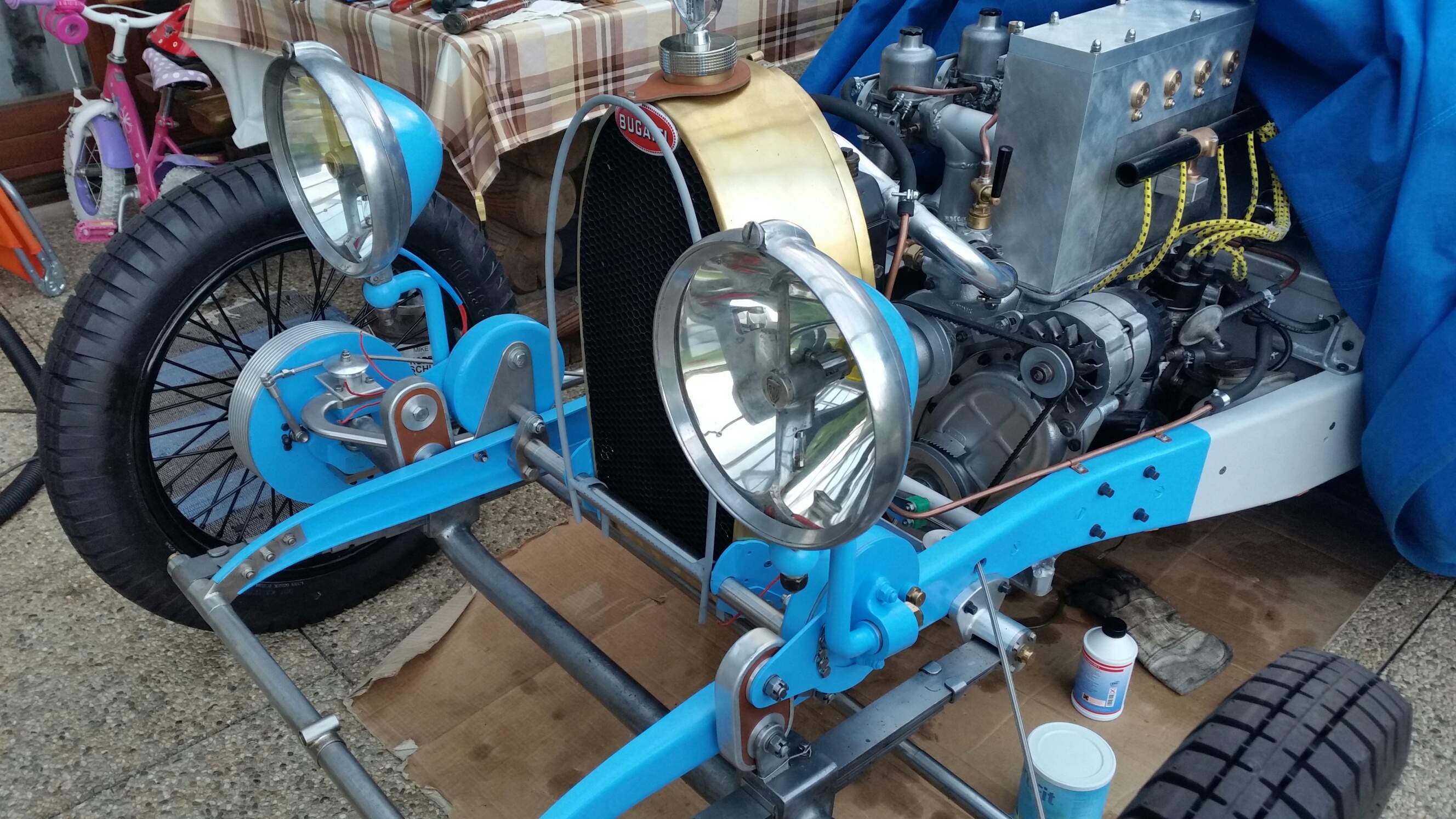

Hello,
Yes, the frame is self-made, 4mm iron plate.
I have a molding (20mm iron plate). It´s made by original drawings!

"Yes, the frame is self-made, 4mm iron plate.
I have a molding (20mm iron plate). It´s made by original drawings!"
I've been wondering as to the best way to do this.
So you cut 20mm plate to the shape of the chassis, then hammered 4mm steel over it ?
After putting the curves in the 20mm plate first of course.
Do you have any photos of the job under way ?
