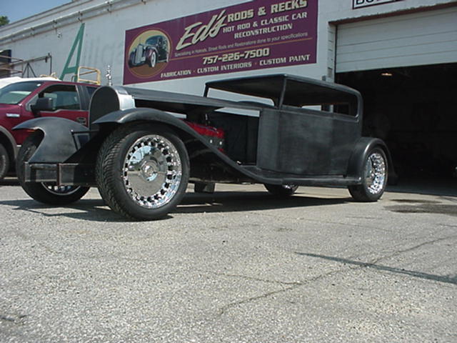

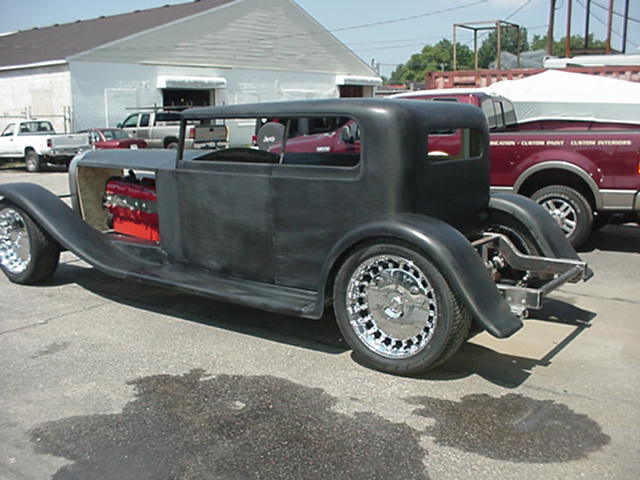

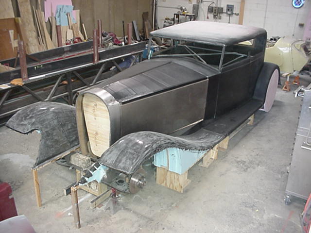

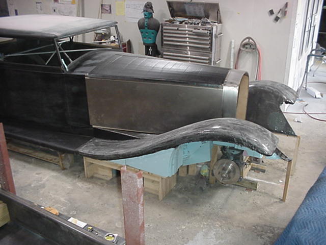

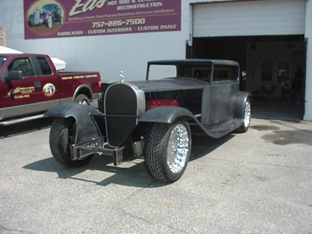

Thanks for the feedback. after a year of building this was the first time we had the car rolling so we could roll it out of the shop and stand back and see what we have created.
Myself and a friend Ron Dyer are building the car we started a year ago. the body is fabricated in what is called the cold molding process,forms were set and a foam core 1/2" thick was shapped over them then 7 layers of CARBON FIBER CLOTH was applied. the forms were removed one at a time and 7 more layer of CARBON FIBER was applied to the interior. we have used approximatly 200 yards of material so far and not done yet.the A and B pillers are fadricated out of 3/16" steel and boxed.
DETAILS
169" wheelbase
24" rims
35.5" tall tires (150MPH speed rating)
702CU.IN. 11.5 liter V12 ( THUNDER 12)
51IN. to the top of the grill shell from the ground
The fenders have been widened to the inside to make room for steering(the tires are 13" wide)
Front frame rails will be cut to shape after frontbumper is fabricated.
Thanks for the input good or not so good. Our vision is to produce a street rod that pays tribute to this magnificent car while being able to be enjoyed by many.
 Post subject: Re: ROYALE STREET ROD
PostPosted: Sat Aug 18, 2012 9:48 am
If you want to bulk up the carbon fiber, try and source some carbon fiber multiaxial (non crimp fabric) which can be much heavier, reducing the price per pound drasticly. It also saves you from quite some labour.
Another thing is that you should not mount metal parts directly onto the carbon fiber. Especially with moisture the metal can dissolve quite rapidly. (not a major concern for a car in a dry climate, but over here it can be problematic.)
Isolate the carbon fiber with glass fabric, or use plastic bushes.
PostPosted: Sun Aug 19, 2012 1:46 pm
Joined: Mon Jun 18, 2012 5:30 pm
Posts: 12

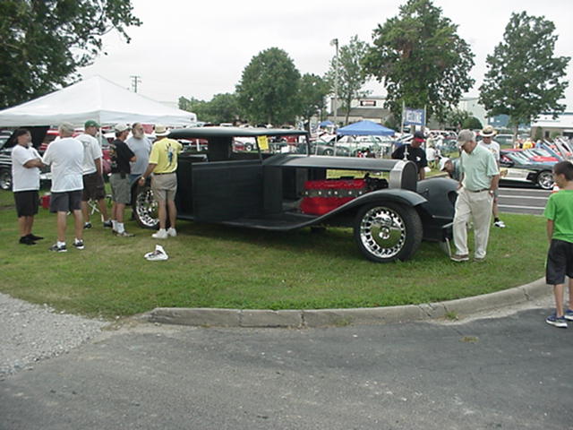

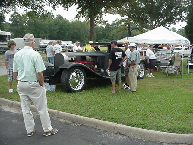

We isolate the steel in a high density epoxy filler before we put the epoxy impregnated Carbon FIBER on. I looked at that material but decided on the plain weave with a multi cross layup to transfer stress evenly.but thanks for reminding me I can use the fabric in some internal areas.
We entered the car in the Chesapeake Va. Shriners show Saturday great responce and turns out large BUGATTI fan base.

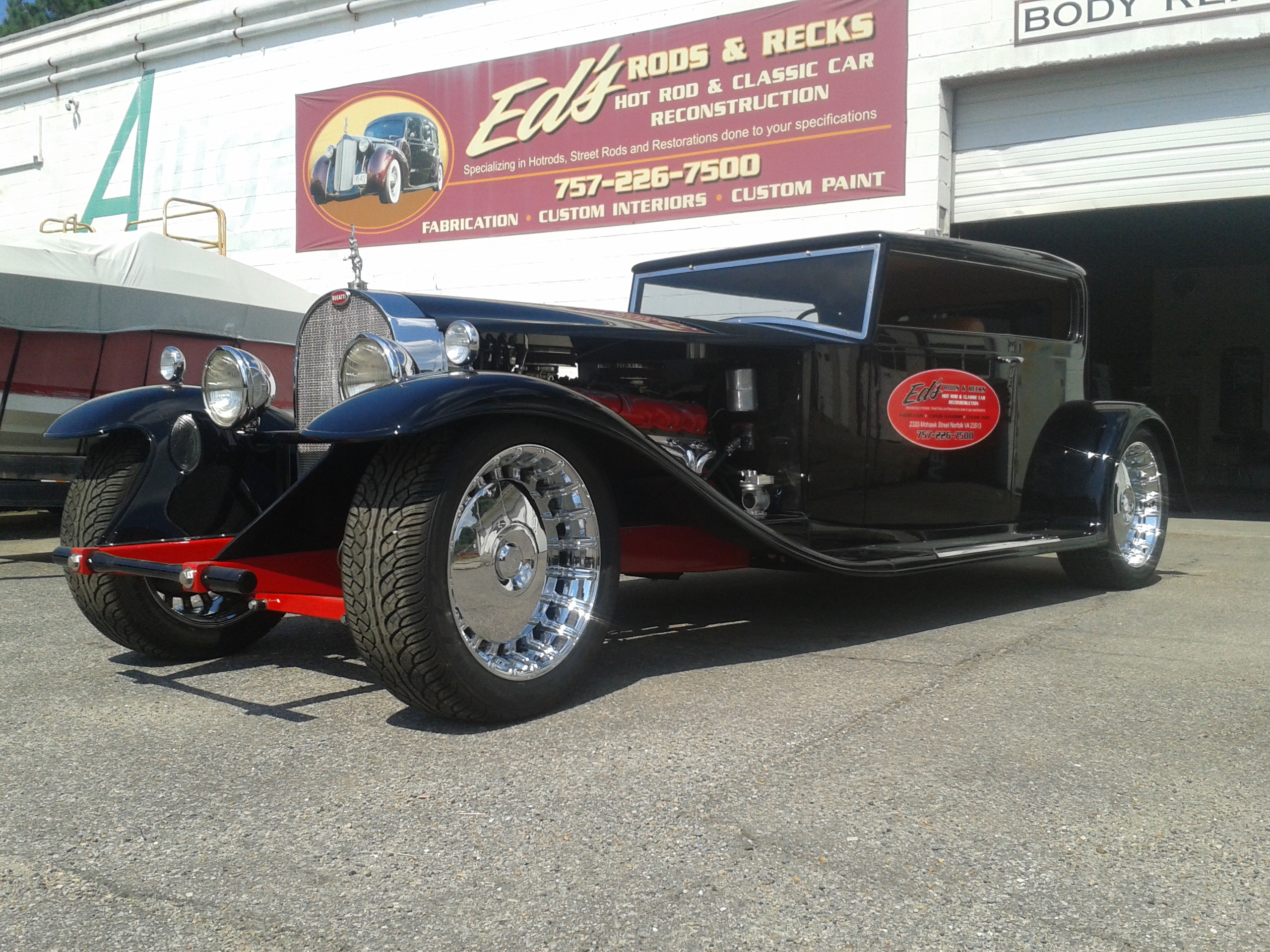

PostPosted: Thu Sep 19, 2013 7:14 pm
Posts: 12

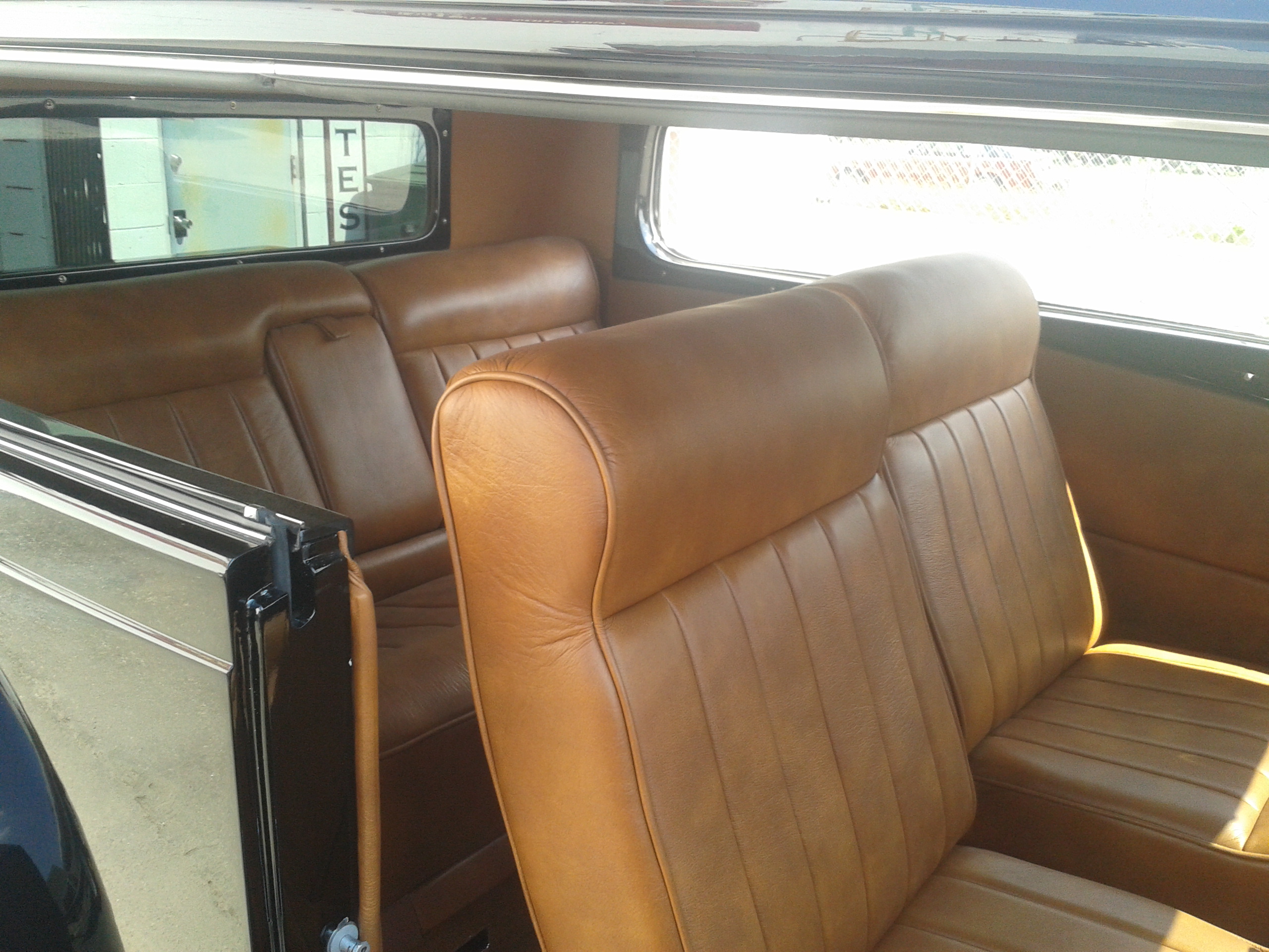

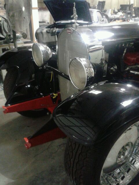

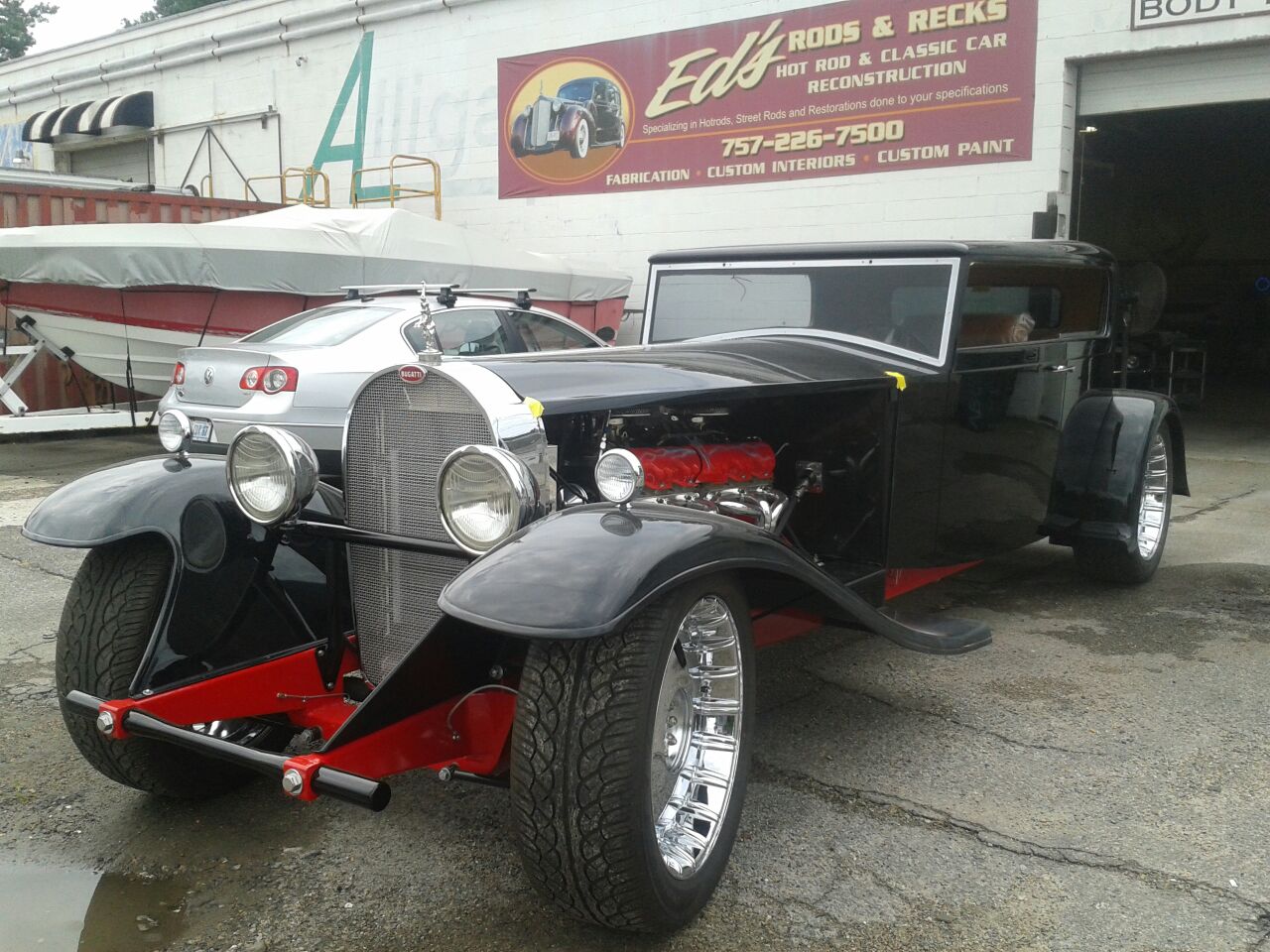

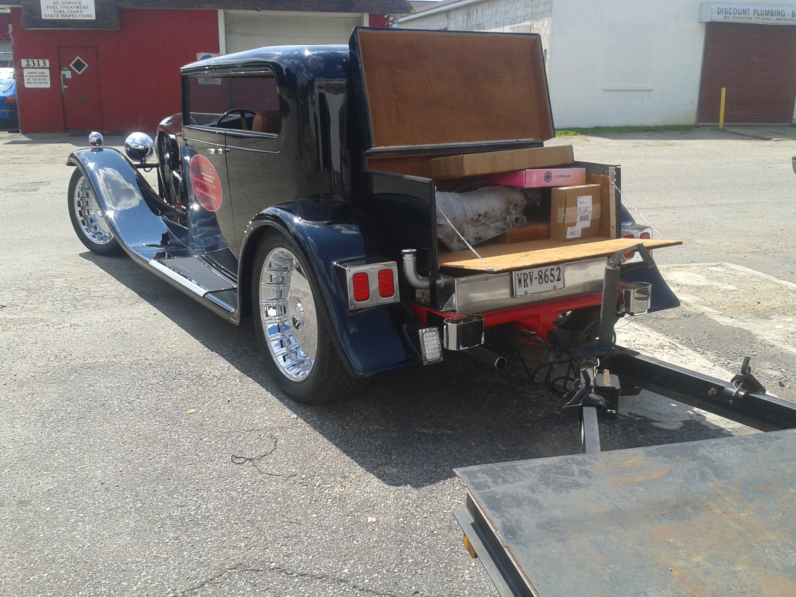

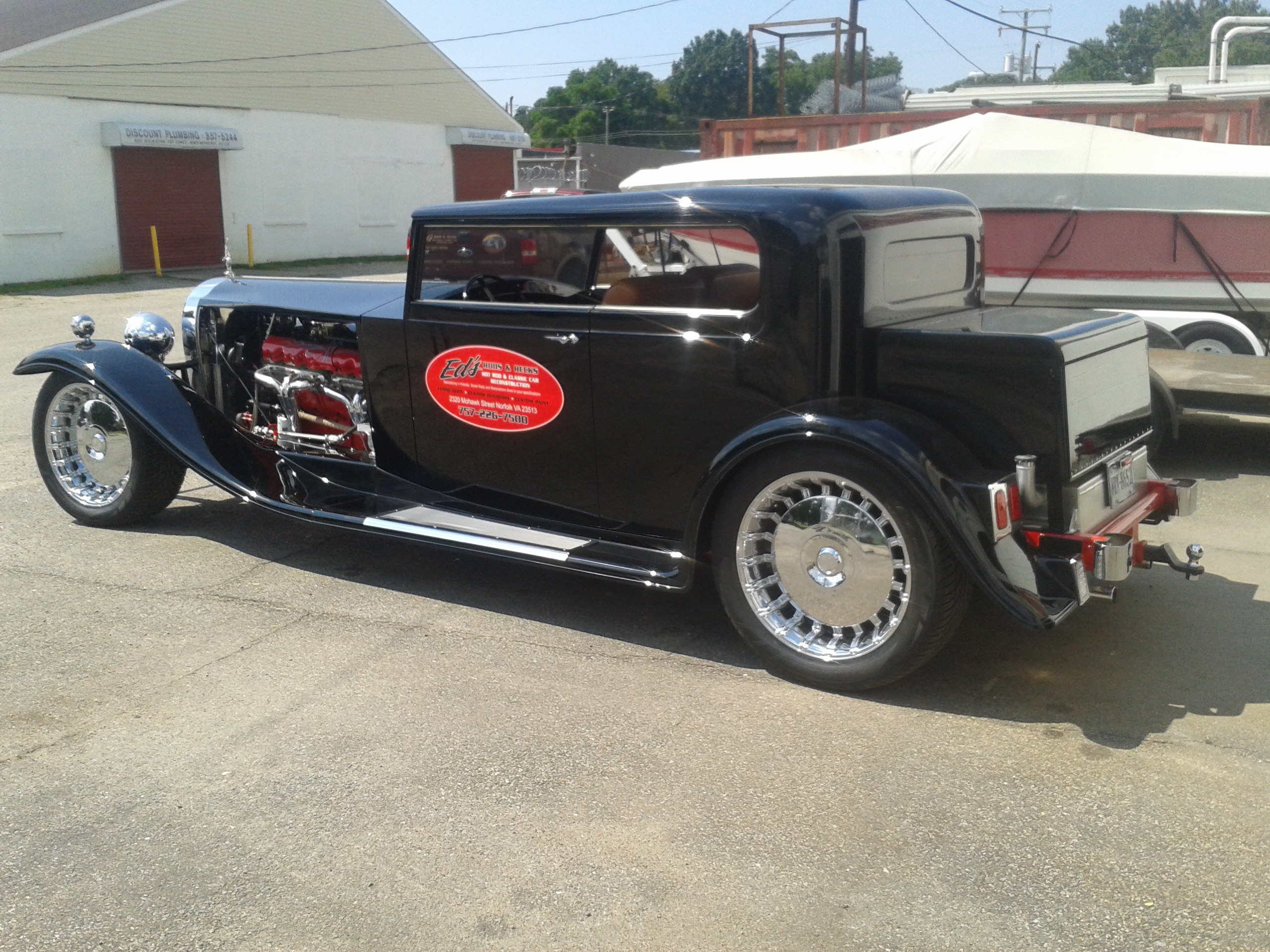

After a year of work all done but some details. their are a lot of build pictures on my web site.
http://WWW.edsrodsandrecks.com
The side panels for the hood are in paint now.
thanks for the comments in advance ed m
PostPosted: Thu Sep 19, 2013 7:51 pm
I really like what I see. Also the tow hook.
Unfortunately no flat screens, and boom box in the rear.
