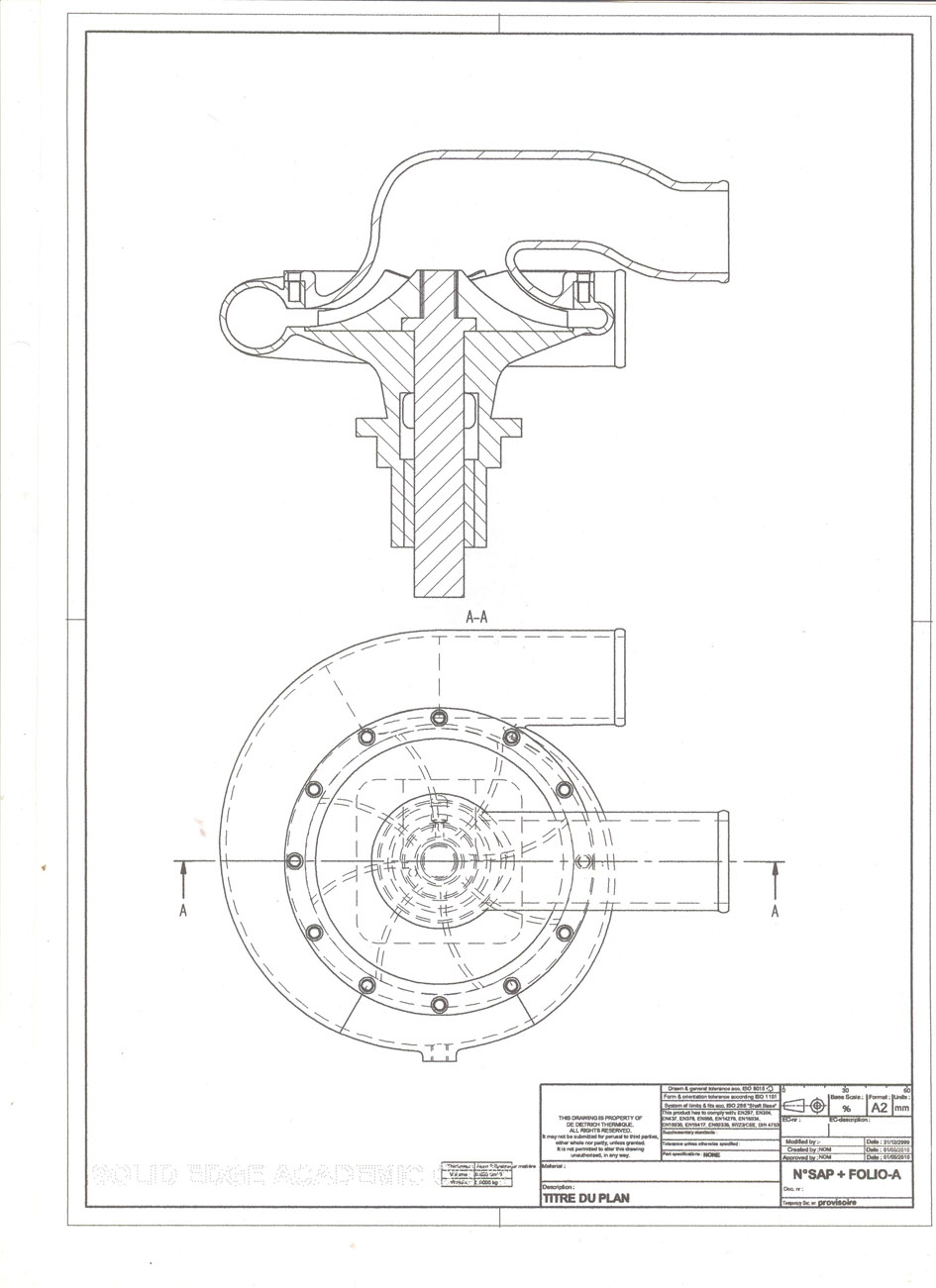

I got most drawings ready for the missing parts

Sorry to p*** on your strawberries Udo, but the water pump you have drawn is totally wrong.

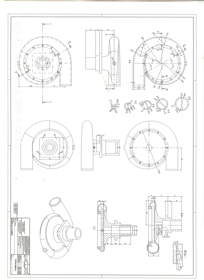

it took a while ,I thought, it comes a little earlier . Do you like this one better? :wink:

On the cross section, leave the pump vanes that are not crossed out, as they only make for confusion. Took me a while to figure out.
On shape I cannot comment, I did not carry around T41 waterpumps lately.

Which of the two drawings is correct, as they are quite different!

That drawing is just as wrong as the other one. The original drawings of the water pump are very faded and there was an early and a late version. What are you copying from/

the first drawing is the water pump for the Type 5 . Second one is new made from the original Royale drawing . As you can read , this drawings are made at " De Dietrich " . the only place today to build historically Bugatti parts . Almost historically. But there is no other place with a connection to Bugatti like De Dietrich . And all happens in Bugatti`s first original workshop .
 Post subject: Re: Royale Progress
PostPosted: Sat May 05, 2012 6:05 pm
Still totally wrong though...

I did not compare the new drawing with the original . What is for example wrong ?

For example, everything is wrong. While it resembles a generic Bugatti water pump, it is wrong in every detail, apart perhaps for the inlet pipe.
Why are you going to such trouble to redraw all of this if you don't have the correct info to start with.
What are you doing it for?

This drawing is made from the " Original Royale " drawing . But next week I will look at it if realy everything is wrong .If realy all is wrong , it would be a surprise .
