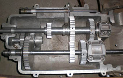

first prototype . Next step, build the bevel gears for the differntial .

hey good photo of the straight-cut gears
a great job on your T5 gearbox
may i ask in your photo
is this a polymer for the bevel-wheel?
 Post subject: Re: T 5 gearbox
PostPosted: Thu Jan 31, 2013 7:04 pm
Yes , this is a polymer . It is for testing the machine adjustment . After it is ok in polymer , I cut it in steel . All gears for the T5 are ready in steel .

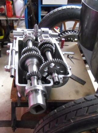

this is the new shaft 42mm diameter hardened and ground . With the new gears made from steel and case hardened .

Nice work on these gears! Do you know how the gears were hardened in the 1920's ?
PostPosted: Fri Feb 08, 2013 3:33 pm
Case hardening ,

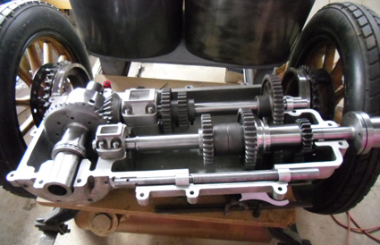

How the gearbox looks today . The bronze bushings are still missing .
