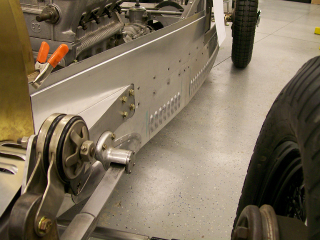

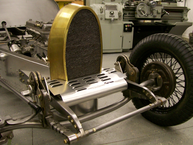

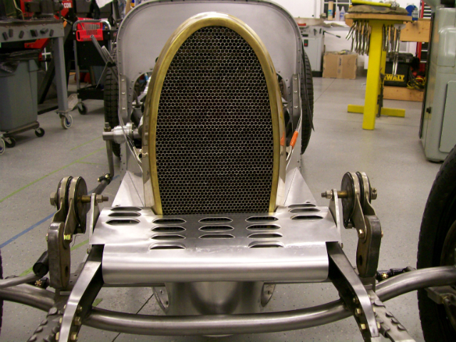

A few of you have been asking to see updated pictures of my GP build. I have made some good progress lately on the radiator and some of the body panels, so here you go....

Nice panel beating!
Splendid work.I must ask though,why not go the extra mile? Why beat out a radiator shell in brass instead of nickle ? I did it for my daughters car and if I can do it anyone can.Why no starting handle boss on the front cross tube? You can fit a handle to the AR motor just as I did to the Riley motor.I assume that the modern bolts are temporary.I [ and a friend who is doing the same thing with an AR motor would like to see photos of the engine mounts and gearbox mounts].Great.

Thanks for the compliments.
Lazarus - as to your questions;
Yes, I will be using different fasteners during final assembly - probably bugatti fasteners but not totally sure yet.
As to the brass radiator - thats just what I wanted. i like the look of aged brass, and I am going to attempt to let the car age naturally and hopefully have it look a bit older than it actually is. So, it was a choice, not a shortcut. Will probably paint it with laquer as well...enamel looks to perfect and doesn't age well.

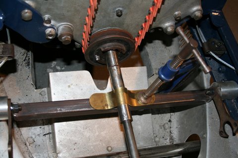

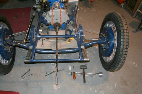

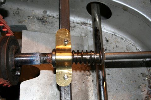

Using a crank to actually turn-over the Alfa motor is an interesting idea that I never considered. Do you have pics of how you did it on the riley? I didn't want to put in a fake crank, but a real one is different.
Oh dear ! I dont think you understand.The Bugatti radiators are not made of brass. 8) They are made from nickle [a metal] otherwise called german silver.They are not normally plated but simply polished.[some people who know no better do plate them usually over the other side of the pond] They do not need plating as they are already the right colour.A brass radiator will look well...... brass coloured.And apart from looking very odd will certainly go green if not treated.I have fitted cranks to my T50 special with jaguar motor,and to two T37s with riley motors.You need to get the two mating parts from just about any old car starting handle and make up the brackets etc and Bugatti handle to suit.I will post photos of the riley arrangement that I made for my daughter.Incidently the original Bugatti radiators are not one piece turned over to make the flange at the front.....the flange is a separate piece soldered on.I did not do this on my daughters car as it is rather difficult to justify the enormous amount of work involved.I can copy the starter handle drawing for you if you want it.

Thanks for the pics Lazarus.
Yes - I know Bugatti radiators were not Brass......I am saying that I like brass, so I used it. I have other cars with brass radiators, so I know how to keep them looking great.
I will give the crank some real thought - I like that.

There is no electric starter on the riley engined car [or on the other two mentioned] so the handle is a must.
