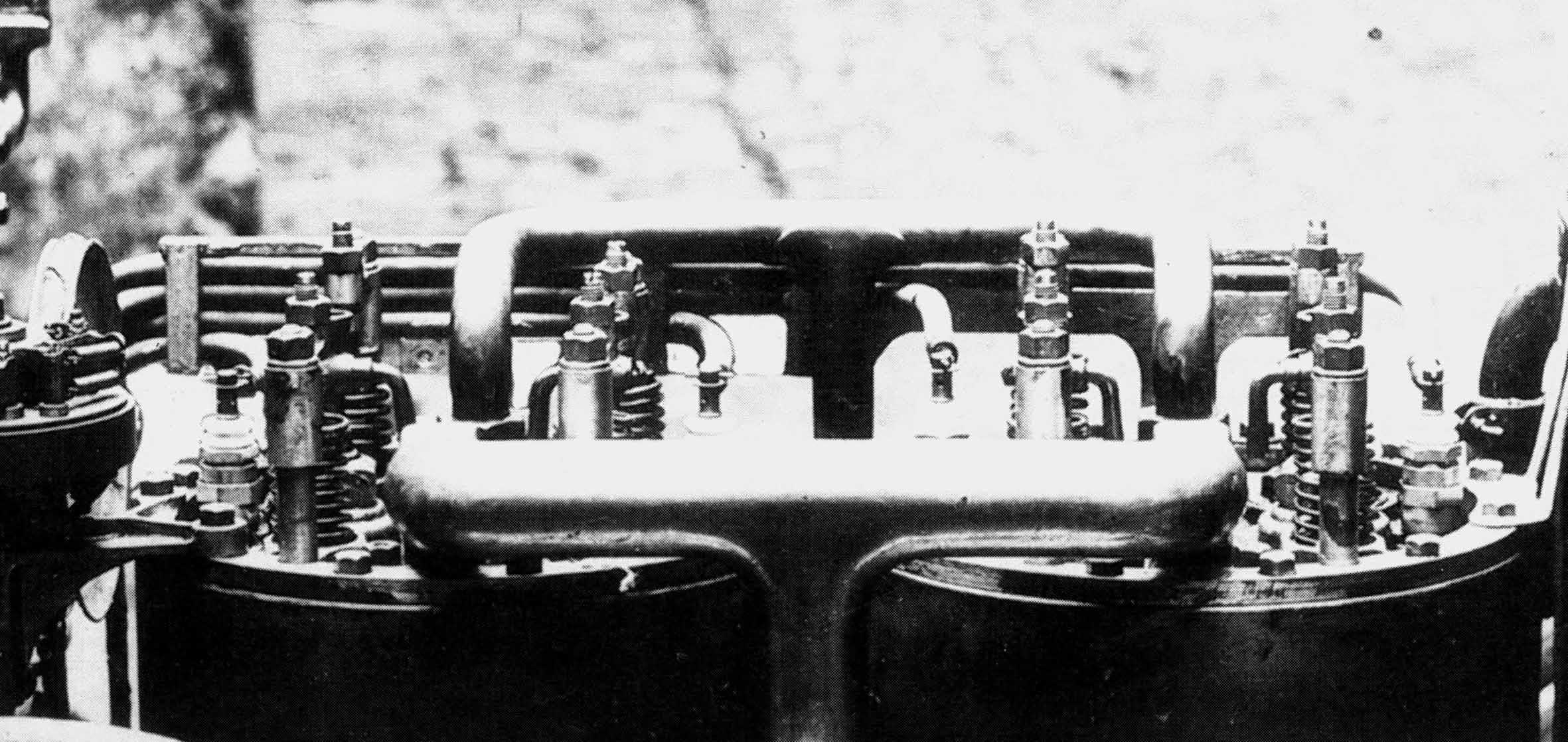

Hello,
Many people did ask me to show some fotos about theType 5 project. The foto shows the first time I did see the Type 5 engine at the De Dietrich castle in Reichshofen (Alsace).
And I got my first surprise , where are the spark plugs ?

PostPosted: Tue Apr 20, 2010 8:02 pm
original foto . Easy to see , the spark plugs are on top .

PostPosted: Wed Apr 21, 2010 7:09 am
I guess the spark plugs are below the black wire that can be seen in the first photo. But did they use modern plugs? They must be small, as you cannot see them.
Or is it a diesel? :)
PostPosted: Sat Apr 24, 2010 7:15 pm
normal modern spark plugs , deep in a hole , so you can not see the spark plugs . No idea why they did change the original design ? De Dietrich did build many engines with the original Bugatti design for street and racing cars and had no problems with the ignition system . I like the idea about the diesel , but for a diesel you need high compression. This is a new build engine with 100% no compression at all ! I am getting differend storys who is responsible for this engine , but all I know, he should not build engines . I will dig aut some fotos we made and post them later .
