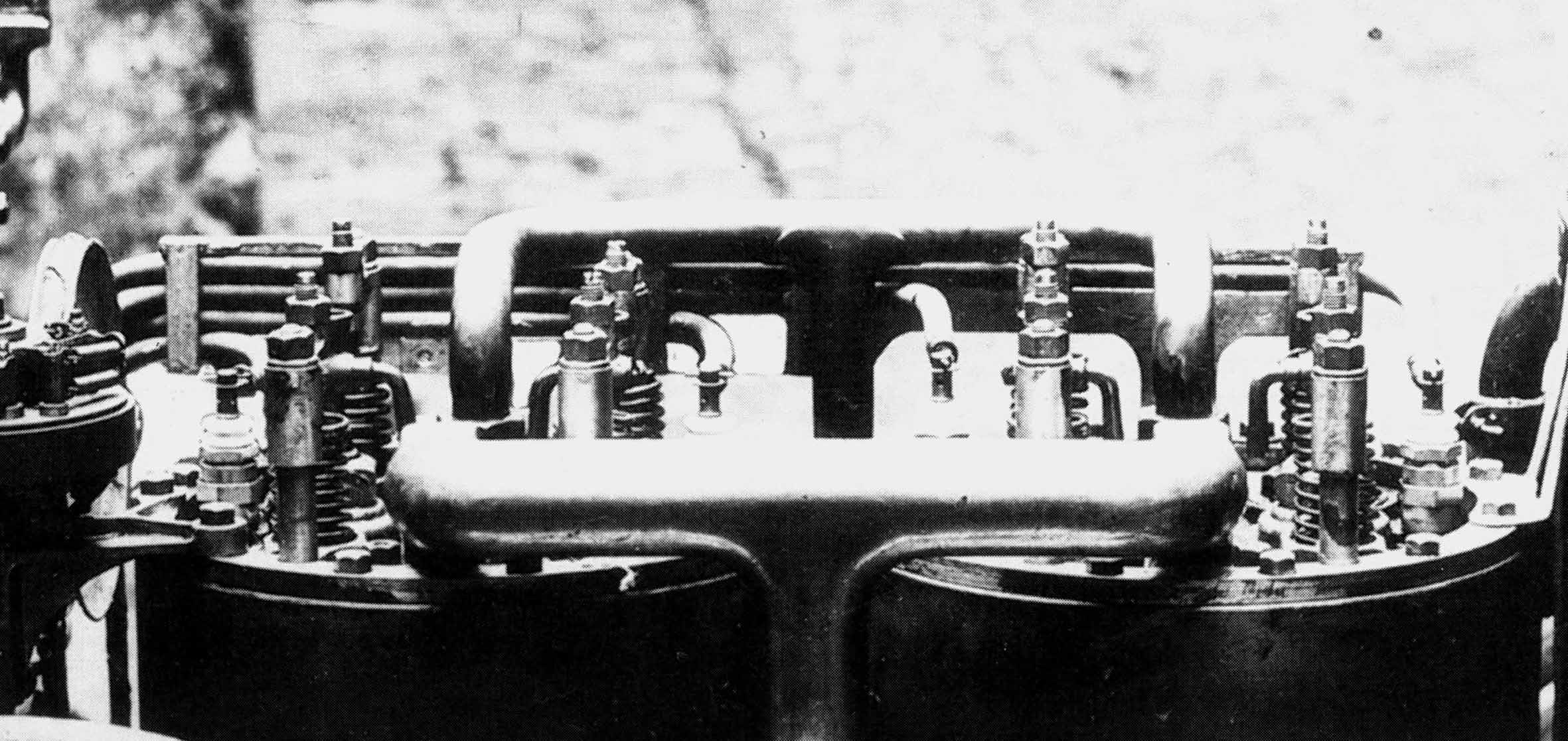

Hello,
Many people did ask me to show some fotos about theType 5 project. The foto shows the first time I did see the Type 5 engine at the De Dietrich castle in Reichshofen (Alsace).
And I got my first surprise , where are the spark plugs ?
PostPosted: Tue Apr 20, 2010 8:02 pm
original foto . Easy to see , the spark plugs are on top .
PostPosted: Wed Apr 21, 2010 7:09 am
I guess the spark plugs are below the black wire that can be seen in the first photo. But did they use modern plugs? They must be small, as you cannot see them.
Or is it a diesel? :)
PostPosted: Sat Apr 24, 2010 7:15 pm
normal modern spark plugs , deep in a hole , so you can not see the spark plugs . No idea why they did change the original design ? De Dietrich did build many engines with the original Bugatti design for street and racing cars and had no problems with the ignition system . I like the idea about the diesel , but for a diesel you need high compression. This is a new build engine with 100% no compression at all ! I am getting differend storys who is responsible for this engine , but all I know, he should not build engines . I will dig aut some fotos we made and post them later .

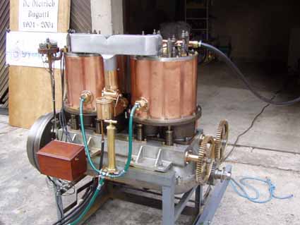

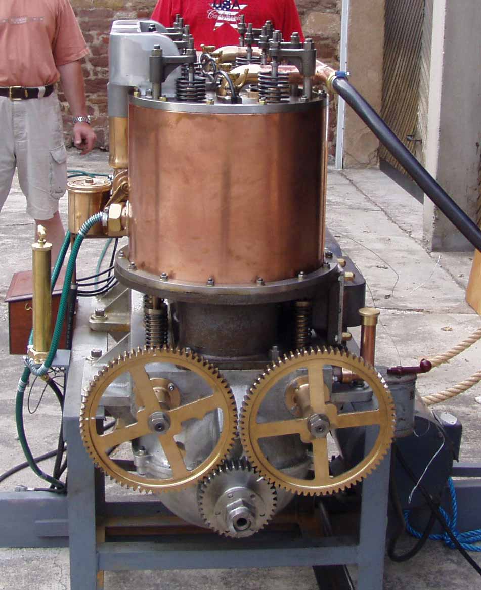

PostPosted: Mon May 24, 2010 11:26 pm
the engine was at the De Dietrich Chateau in the Alsace . We started the engine with a 5 HP electric motor . You can see the motor at the right side , first foto . The electric motor was just able to turn the 13 liter engine . Some noise , some smoke , but not realy running . During the electric motor was turning the engine , I did open and close all the pet cocks , but the engine did not care about it at all . All People told me , it is a problem about the 13 liters and the 5 HP motor is not powerfull enaugh . Bugatti did not use a 5 HP electric motor in 1903 !!!!!!!!!!!!!!!! I did remove the spark plugs , and there was no change , the electric motor still had a problem to turn the engine . So , absolut no compression ! I started to take the valves off . Surprise , the valve has 45° and the valve seat 55° ! The valve seat was made from bronze and was out off shape . I was able to look through . Up to 1 mm gap between valve and valve seat . But why was the 5 HP motor not able to turn the engine with a higher speed ? A very high mechanicale resistend with the crankshaft bearings and the valve train .

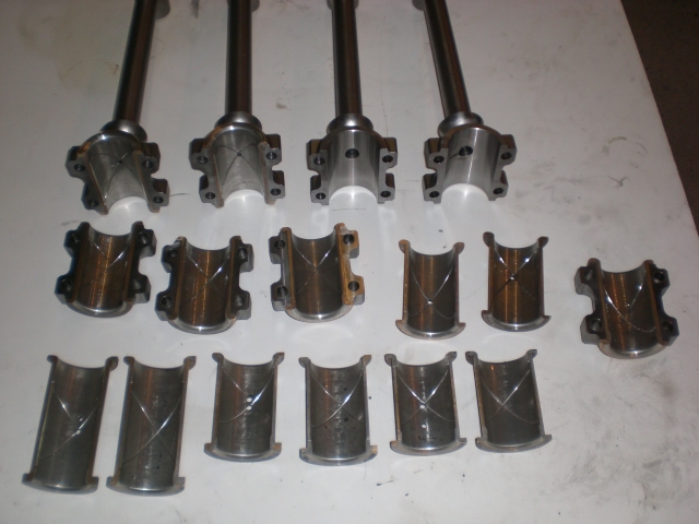

PostPosted: Thu May 27, 2010 1:19 pm
Thanks for your support ! With the spark plugs aut , it should be easy to turn the engine , but it made no difference .
The bearing diameter was not the real problem . The clerance was only in some spots to tight . All 3 main bearings had no side clearance . All 3 main bearings are machined to fit exact the crankshaft journals . No babbet , only bronce , and no oil groove . No hole to lubricate the center bearing . So I made neu bearings .

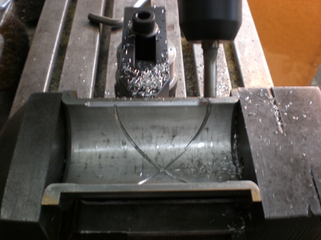

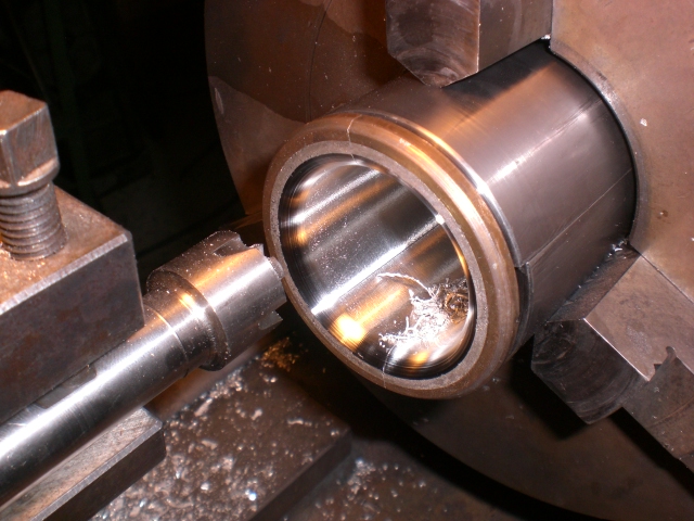

PostPosted: Thu May 27, 2010 1:29 pm
turning the bronce bearing shell with 1000 rpm and the babbit inside . The centifugal force helps to get a wallthicknes about 4 mm .
PostPosted: Thu May 27, 2010 1:33 pm
new bearings are redy
PostPosted: Thu May 27, 2010 1:37 pm
Proper job ! well done.
PostPosted: Thu May 27, 2010 6:00 pm
Looks neat! Let's hope it works. But at least another step towards a running engine.
About the radiator: It could have been lighter. However, wall thickness is not a major influence on heat dissipation. Getting a turbulent flow is important, and therefore speed of the liquid should actually be reduced. Also some sort of mixing device in the flow path is a good idea. Many cars use that today. (I dismantled some car radiators for another hobby I had in the past: watercooling computers)
You did have a fan on the radiator, did you? Air flow is important.
PostPosted: Fri May 28, 2010 12:15 am
Type 5 has no fan . I just had the engine running . After 3 minutes the engine is warm , you still can touch the cylinders and the radiator is cold . It is no water going through .
I have to build a new radiator .
PostPosted: Fri May 28, 2010 5:53 am
You MUST have a FAN for running stationary ! Air MUST be going through the radiator to cool the fins ! When the car is moving the radiator might work.I would try that first.
