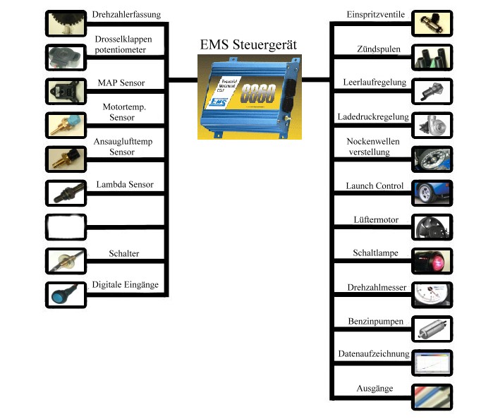

I think you know , it is not a problem today to connect any engine if 1 or 20 cylinders with an ems .
http://www.luepertz-motorsport.de/html/ ... sport.html
8860 Sequentiell Motorsport für 1 - 16 Zylinder Motoren
Just ask them on which 16 cylinder engine they have tested it.
It might work for small engines that you prepare for race cars with huge compromises on drivability, emissions and start-ability but for sure not something you want to use on a road car.
Also you have to check if the Bugatti engine is a direct injection or not and if it has piezo, or solenoid injectors.
For the piezo it needs totally different drive voltages and even some solenoid injectors work with increased voltages.
Going out of existing maps you will for sure lack of power or and burn some engines before coming to something than might run.
Also I can't find any knock sensor or knock control description.
Seen the size of the Galibier engine it has for sure at least 2, most probably 4 of these sensors.
How would you run correct spark values without this?
The Galibier engine also for sure has more than 1 Electrical throttle body but I can't find the necessary outputs.
It has more than one turbocharger that needs to be controlled.
This is not an electrical house installation where you switch 5 bulbs with one switch. :lol:
I's not only the lack of these inputs and outputs but also the required processor to manage all these separate information what is most probably missing.
I'm sure that I can continue with this list till lunch time.
Last but not least that system does not contain any OBD and without that it could not be used legally on modern cars.
I'm sure that with some effort it would run on a 1980 Jaguar as a good set of carburetors and an old fashion ignition system would also do the job on that one.
This is my opinion but I suggest that you just give it a try.
Good luck :lol:

 Post subject: Re: Royale Progress
PostPosted: Thu May 10, 2012 10:20 am
1200 according to Udo's supplier :mrgreen:[/quote]
Correction,
The Veyron is direct injection, so not possible to drive the injectors with that controller.
It has no knock sensors but ion sense detection for knock and misfire. :mrgreen: :mrgreen: :mrgreen: :mrgreen:

PostPosted: Thu May 10, 2012 8:33 pm
first , it is a nice dream to think you can get this engine for 120 000 . In the time the Jaguar XJ40 was a new car , I payd half the car price in Coventry for the powertrain only . This EMS is an example , we are not using it . We do it with aircraft engines , so what is a car engine ? This royale is not the main project , alongside project .
Original Veyron setup are 2 separate ECU's, one per cylinder bank both synchronized one to the other. That's quite difficult to find in aftermarket but I'm impatient to hear what your system choice will be.
