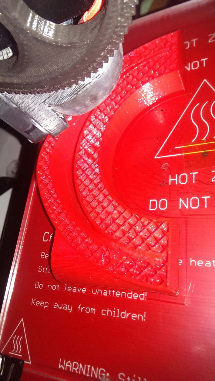

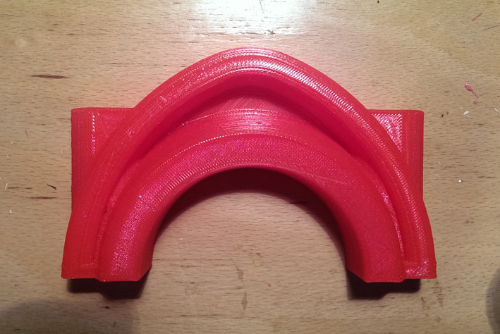

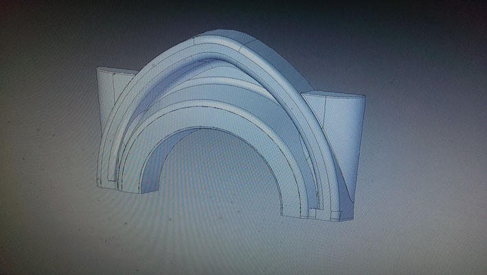

Sand cast pattern made in a 3D printer . The magic new way to make patterns .Compare to use a cnc machine and a router , the printer can print any geometry in one go without turning the pattern to machine the back or the sides .This patterns are lightweight , because they are hollow inside with a for example honeycomb system . Very strong and hard . You can print any geometry you can imagine , fast cheap and accurate .
