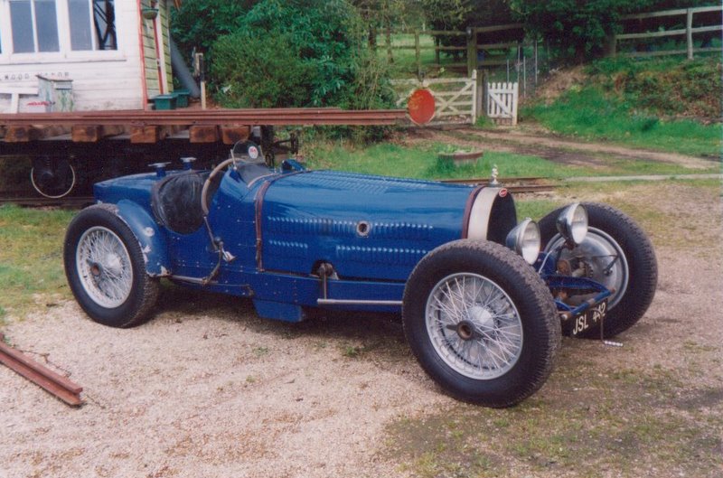

Interesting cosmetic work on a Jaguar 3.8 litre motor ! This is probably quite a quick car.Unusually for an american repro,they have at least got the steering wheel on the correct side of the car.

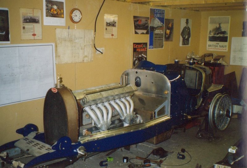

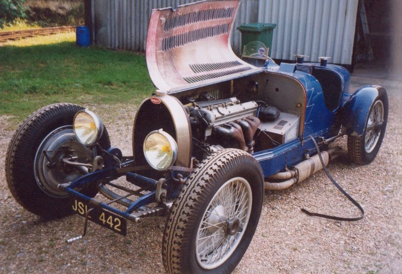

Do not forget my own Jaguar powered Bugatti,and remember that the american car has no bugatti parts at all.

T50 front axle and back axle gearbox.Modified chassis to form T54 shape.

The problem with the carburettors can be clearly seen.I used angled carbs from an AH 3000.I did not want to cut holes in the bonnet.

The car was registered quite rightly as a Type 50 special.There was so much original bugatti it could not be registered as anything else.The MK IIa healey has two 2 inch SU carburettors with the distinctive angle which made them fit nicely under the Bugatti bonnet.The bonnet of this car came from one of the T54 cars.Made probably in the 1950's when a different engine was fitted [also a jaguar !]

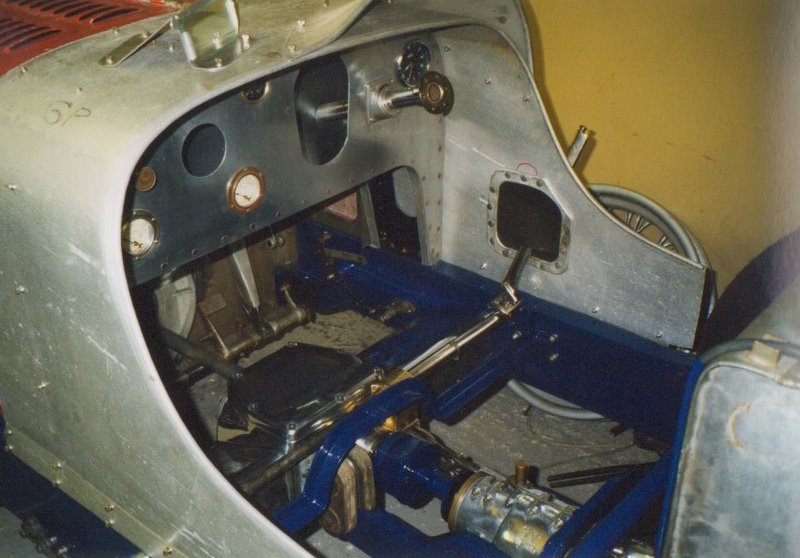

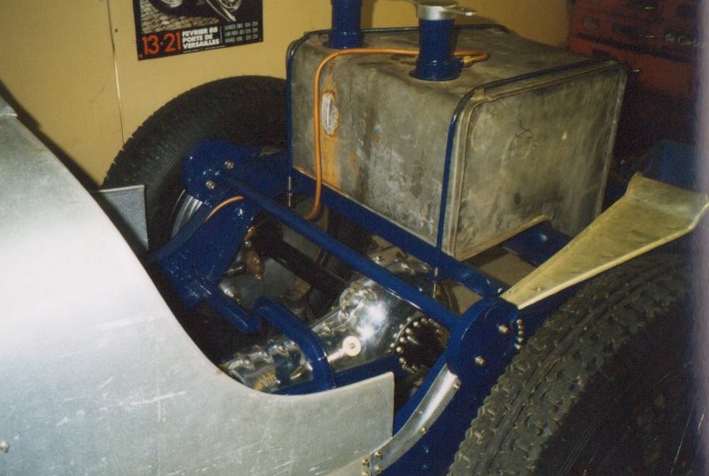

I have always loved making cars like this.As you can see the first idea was to use the T50 motor.Sadly the block had severe damage in one cylinder which would have been very expensive to repair.As the car was for me to play with,and as I had a rebuilt Jaguar 3.8 engine in hand I decided to use it.The T54 gearbox case is empty except for the selector rods.These are connected to the T50 gearbox at the rear.This took some time to arrange and design,but once finished gave no trouble ever afterwards.This was one of the most exciting cars I ever drove.Very fast in a straight line,but as Bugatti discovered not so good in corners.At only about 5 inches long,this was probably the shortest Bugatti propshaft ever.
