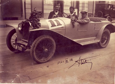

 Post subject: Bugatti imports by Velox
PostPosted: Sat Dec 03, 2011 5:12 am
Joined: Wed Jul 06, 2011 4:04 pm
Posts: 4
Hi
There's not a single entry in the database which says - imported by Velox Autokereskedelmi Kft.
However Velox did bring in a number of Bugatti cars to Hungary between 1924 and 1926. Here's one from 1924 at the Schwabenberg race. At the wheel, Kálmán Farkas, director of Velox, his navigator is Viktor Szmick. And the car carries Hungarian number plate.
