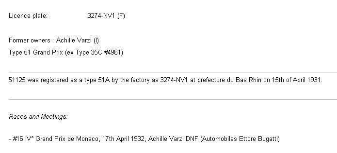

#16 GP de Monaco 1932, Archille Varzi, not with 3274-NV1, thus not 51125

As usual nobody is taking care about the topics here, which is understandable as nobody takes care what is written in the WIKI itself.
So let's start with Uwe's complaint.
As one can see he is right - the registration is 3275-NV1.
So for sure it not 51125. But also not 51123 which was registered with this number, but more to this later. Let's continue with 51125.
Quote:
51125 was registered as a type 51A by the factory as 3274-NV1 at prefecture du Bas Rhin on 15th of April 1931.
51A? It was part of the 4 car sequence prepared and registered for the Monaco GP which took place on 19 April 1931:
3273-NV1 for 51124 with engine 5
3274-NV1 for 51125 with engine 8
3275-NV1 for 51123 with engine 3
3276-NV1 for 51122 with engine 1
Without any doubt the works cars for Monaco on 19 April 1931, for Varzi, Chiron, Divo and Bouriat. So who of them drove a T51A?
Quote:
Type 51 Grand Prix (ex Type 35C #4961)
All sources I know say 4961 became 51132, so what it the source of such statement?
Quote:
#18 IV° Grand Prix de Tunisie, Carthage, 3rd April 1932, Achille Varzi 1st
Did anybody care that Varzi's car there was registered 4924-NV1?
Quote:
#87 Mille Miglia, April 1932, Cazzaniga-Rosa
The Mille Miglia was only 1 week after Tunis. All sources - except the Bugatti Trust - say it was a T43, and by looking closely to the photo and especially the fullsize windscreen I also think this was a T43 GS.
Quote:
#16 IV° Grand Prix de Monaco, 17th April 1932, Achille Varzi DNF (Automobiles Ettore Bugatti)
I commented this already above. But let me have a few words about the time line created here. Used by Varzi as red GP car at Tunis, one week later as sports car by Cazzaniga in the MM, and again one week later by Varzi as blue works car at Monaco. And then it went back to Cazzaniga because he used it also the 1933 Mille Miglia...
