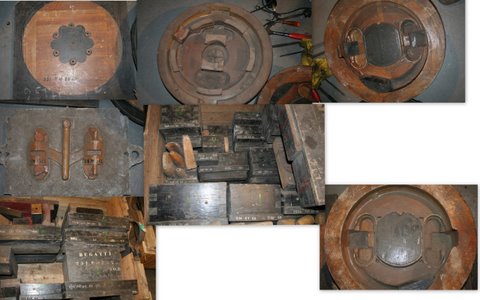

PostPosted: Fri Mar 20, 2009 7:17 pm
here are more pictures of the patterns for the Bugatti disc brakes .These were succesfull and had a vented disc,years before other manufacturers thought of it.
 Post subject: Re: Type 251
PostPosted: Sat Mar 21, 2009 11:31 am
This disc-brake is very interesting. Was a patent applied for? Do you have any patent numbers??
