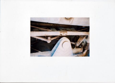

What makes you so sure that the car with the later modified bodywork is T251 002 ? The car that raced was recently at Goodwood and I took this photo of its chassis plate.I shall keep you all in suspense :D

Can I remind Lazarus of a certain "type 35B" we were both involved with some time ago. Did the chassis plate on that car, genuine as it undoubtedly was, really belong on a GP ? I think not.
Chassis plates prove NOTHING. Whatever the number now on the chassis plate the car which raced was the first one made. The second car looks as if it was only just finished in time for practice and lacked the rear-view mirrors and upholstery of the earlier car. Does the appearance of Roland in the pits wearing goggles suggest that the car was driven from Molsheim to Rheims by road to enable Trintignant to practice with it ?

Oh well if you insist ! :P The "mule" was the test vehicle.It has no chassis number.It's engine was taken the night before the race for the "first car" which raced at Reims [T251 001 ].The mule was used after Reims by Roland Bugatti and Marco to try the new leaf spring suspension.It is in the schlumph museum and it is the car with the body removed for display.The car that raced has the number T251 001.There is no T251 002.T251 001 still has the odd crossover suspension.If a certain well known Bugatti scribe had bothered to study this period in the 1960's there would be less confusion today.
Leaf springs? I see coils!
