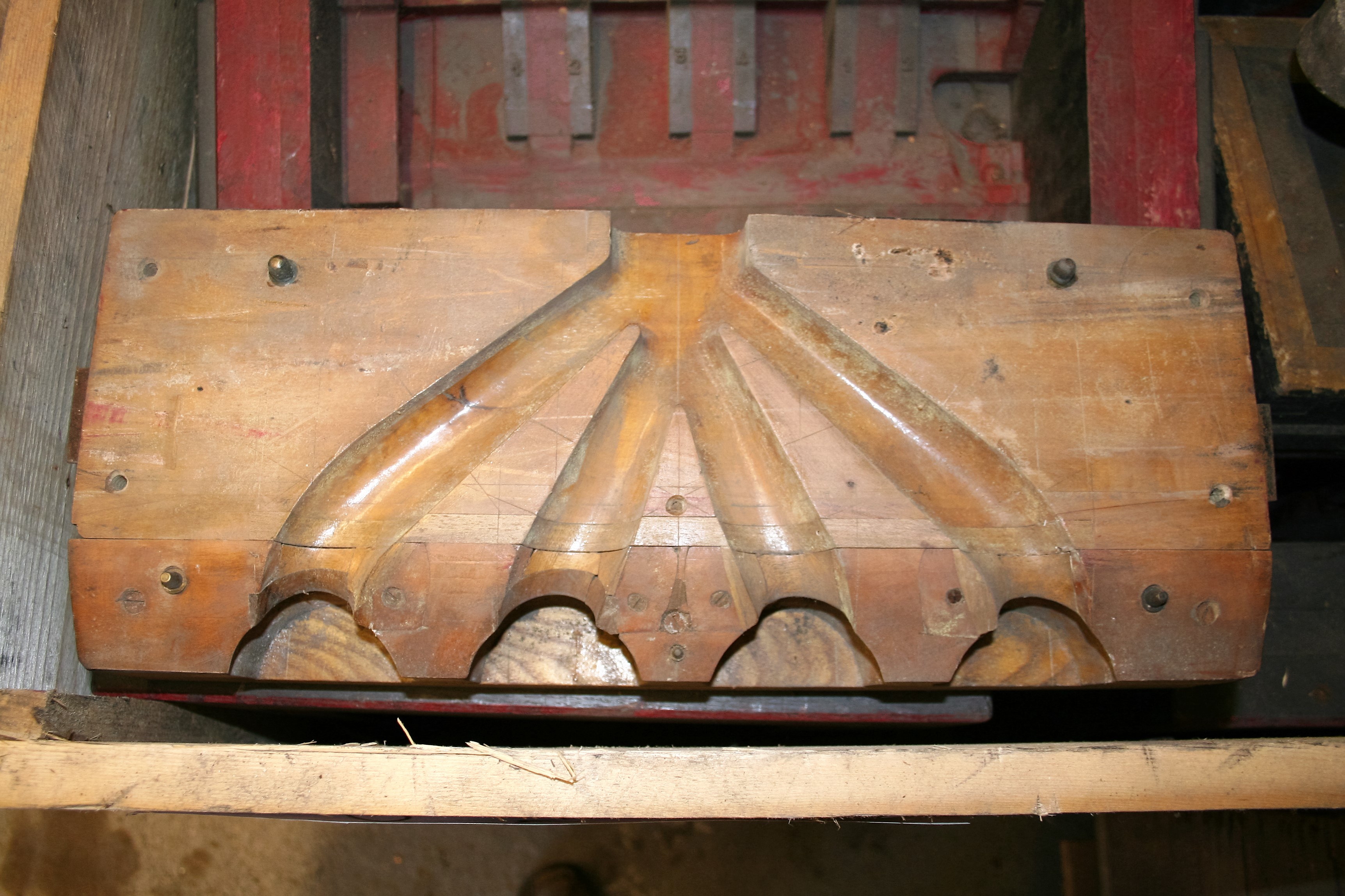

Here is Edouard Bertrands strange attempt to improve Colombos T251/2 cylinder head.This is the corebox for the internal inlet passages in the head.Colombo had four separate tracts all of the same length.
