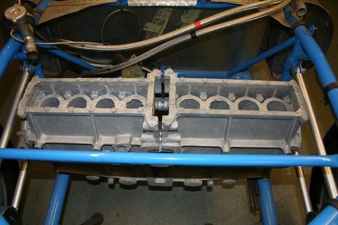

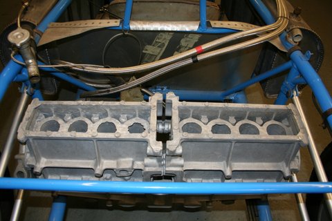

Hot from the foundry this afternoon.My two new blocks for the T251

Very courageous! They look good.. did they cast "right first time"? Do you have tooling / casting method data or just patterns for the parts? Did shrinkage work out OK? Did the foundry make its life easier by pouring them very hot? Fingers crossed for no surprises during machining!
 Post subject: Re: T251 Blocks
PostPosted: Sat Feb 13, 2016 8:23 pm
The original patterns are in perfect condition given that we are now in the 61st year since they were made.All the castings came out right first time.We have aluminium and also magnesium blocks.Bugatti made both types.All checks made so far indicate that the parts will machine to drawing.The heads will be along soon within a couple of weeks. I have made a small change to the valve gear. This required 7 small new coreboxes. I am going to use conventional valve springs and buckets,rather than hairpin springs.
