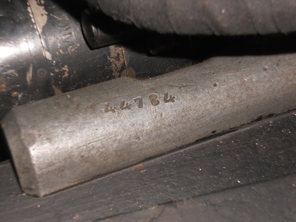

 Post subject: Re: Bugatti T44 Chassis No 441074/1 change to 441320 EN 1074
PostPosted: Mon Oct 22, 2012 9:21 am
Posts: 57
Enclosed is a photo of the Engine Number it is 44784 stamped on the rear engine frame next to the starter motor.
1930 Bugatti T44 Profilee Body by Jean Bugatti Chassis No 441320 Engine No 1074 ZK.jpeg
1930 Bugatti T44 Profilee Body by Jean Bugatti Chassis No 441320 Engine No 1074 ZK.jpeg [ 159.57 KiB | Viewed 16661 times ]
PostPosted: Mon Oct 22, 2012 10:37 am
Hi,
Are these numbers original stamping or restamped at a later stage.
Are they of correct size and form?
On T57's they are much larger.
Greetings:
minime
PostPosted: Mon Oct 22, 2012 10:53 am
They are not engine numbers they are a chassis number stamped on the engine leg though as minime says they seem the wrong size for 44 as well perhaps a re-stamping?
