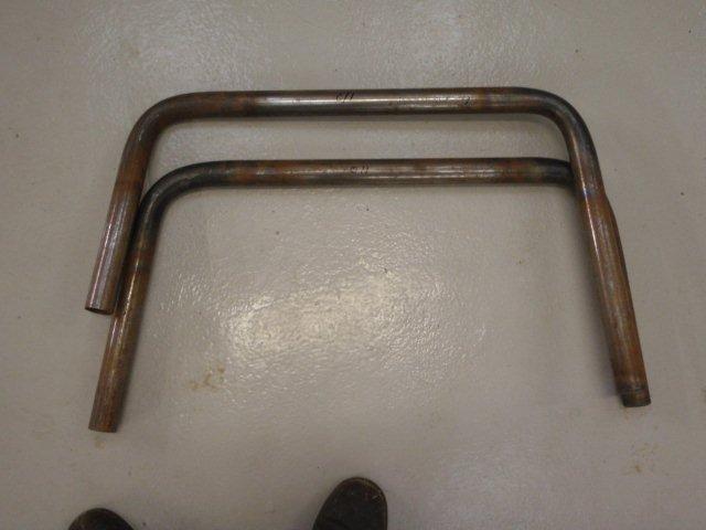

OK as herman in his last post has asked for more technical info can anyone tell me what’s wrong with this picture?
Anyone but bugwrench or Lazarus (who will see immediately) who answers correctly may win a prize ;-)

and next time you better use a proper tube bending machine .

    They are someone's idea of the start of a gearbox x member so what's wrong?

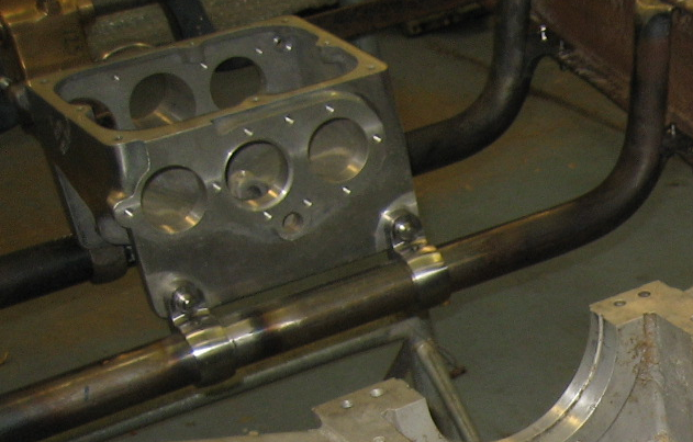

    Come on boys play nicely ,I can see the best vintage aero engineer in Germany and the Best fabricator in Poland need some help here’s a clue.
    Now what’s wrong with the first photo?;-)

    perhaps my humour failed to pass the language barrier. The post was simply to make people think A little about how the factory actually made parts rather than what the drawings seem to show im sorry you seem to have missed the point.
    I was trying to show the importance of context, if you look at the second photo more closely you will see that the pre bent tubes are not usable as the lugs will not fit past the bend they need to be in place before the tubes are bent. The only solution to make the tubes in the first photo useable would be to cut and rejoin the tube(not ideal) And naturally not something the factory did.
