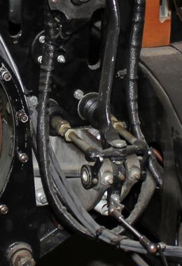

It looks like the old engine mount with no rubber .But 2 master cyliner , one for the front and one for the rear .

The picture you posted is quite small but is that an electrical brake pressure switch they fitted there?

It seems that on another picture there are well two feed lines going down to the master cylinder area so there are 2 cylinders fitted.

Have a look at this .
 Post subject: Re: T57 brake
PostPosted: Tue Jun 12, 2012 9:00 pm
According to the trust only cars built in 1938-1940 were hydraulic Breaked ie all ruber mounted engines so any solid mounted engine cars with hydraulic breaks would ben retrofited as an 'update' weather factory fitted in period or not .
